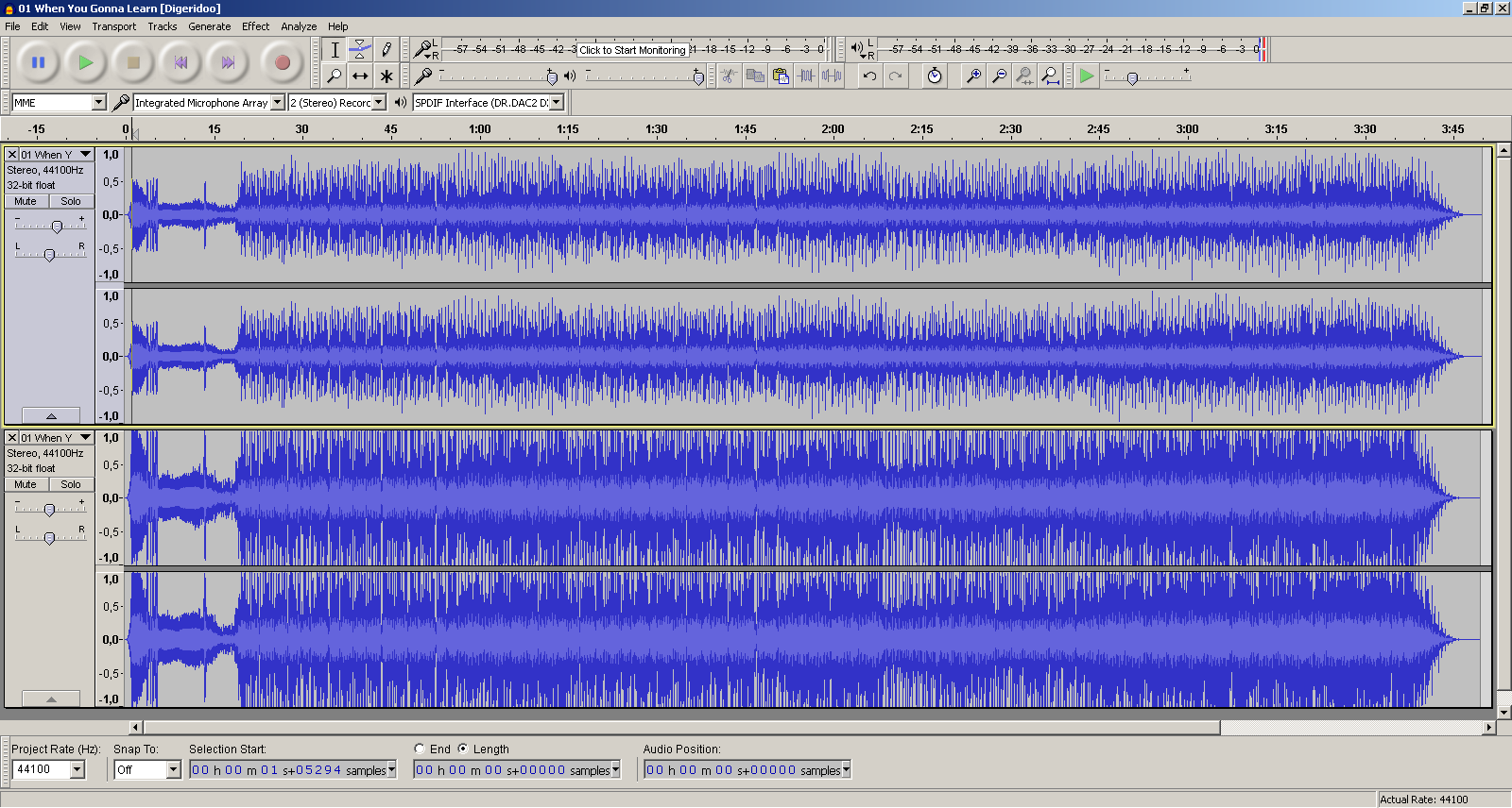

The DR measurements are basically a measurement of the difference between the average loudness of the music and the peaks in the music. The higher the number, the better the recording and mastering were done. When compression is applied during mastering, clipping occurs. Clipping is a form of distortion in which the peaks are flattened. Audacity is a program that can show you the waveforms of the music and it can also show any clipping in the music. To illustrate what the difference can be between a low and a high quality recording I made a few screenshots you can see below.
Which one do you think sounds better? The one below is a full 7dB louder!
This is what using of the full dynamic range available on CDs looks like!
Not all electronic music is poorly produced. The red lines show where clipping occurs. The first song shows clearly a very wide dynamic range while the song below is by far the most compressed song I own.
