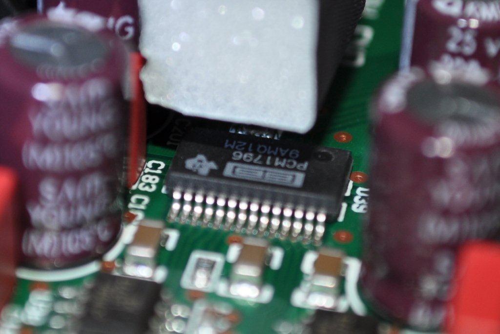

Burr Brown PCM1796 digital to analog converter
