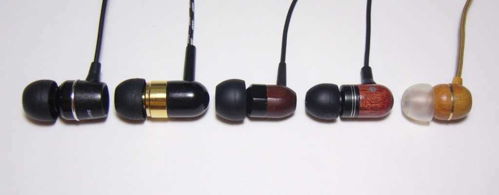

*Left->right: Xears TD-III, Woodees Blues, Thinksound TS02, Fischer Audio Daleth, Skullcandy Holua
All of the earphones feature a conventional, straight-barrel form factor. Their fit differs only in insertion depth (as a function of nozzle length and housing diameter) and stability (as a function of weight and tip quality). The Thinksounds and Fischers can both be inserted fairly deeply as they have slim housings and long nozzles but the stock tips on the Daleth could be better. The Woodees are on the opposite end of the spectrum, with large housings and fairly short nozzles. The Xears and Skullcandies are both rounded at the front and can seal comfortably despite being slightly larger than the Fischers and Thinksounds. All of the featured earphones can be worn over-the-ear but the large size and long strain reliefs of the Woodees may pose problems with cable-up wear for some users. In addition, the sets with microphones and in-line remotes may be less convenient for over-the-ear use. In the end, long-term comfort will always depend on the individual user but I find the Thinksounds and Skullcandies to be the two to disappear in my ears quickest, followed by the Xears, then the Daleth, and then the Woodees.
