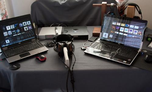

Associated Equipment & Setup
  1. Music - Jazz, fusion, electronic, prog rock and more
  2. Source files - FLAC lossless on Synology NAS (16/44 to 24/192 PCM & DSD) via ethernet
  3. Player - Dell Studio XPS laptop (Windows 7 64-bit) running JRiver 20.0.115 and Roon 1.0 build 21 / WASAPI and ASIO via USB
  4. Headphones - HiFiMan HE-560 w/ Norne Draug 2 + both Focus and Focus-A pads.  Also - MrSpeakers Alpha Prime, Senn HD600, OE Audiosystems custom modded T50, Shure SE-500
  5. Standalone amplifier - Luxman SQ-507X (vintage early 1970s transistor amp)
  6. CD transport (used to test coax and toslink digital inputs) - Little Dot CDP1
  7. Other DACs available for comparison - Chord Hugo TT; Geek Pulse Infinity; Geek Out 450; CI Audio VDA2/VAC1

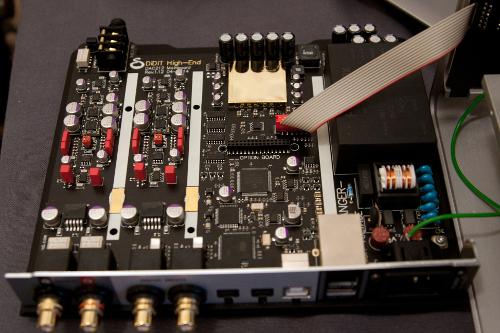

Lifting the lid, you get some more appreciation for the thought that went into the chassis.  Those three silver metal strips that run most of the depth of the board mate up to similar protrusions in the chassis cover to provide extra shielding between digital, analogue and power sections of the board. The DAC212 uses the well known flagship chip from ESS, the Sabre 9018S. If that immediately has your mouse pointer running for the X on your browser tab, keep an open mind - not all Sabre implementations are created equal. With a recent resurgence of interest in non-oversampling and R2R DACs, the Sabre chip is sometimes (often unfairly) associated with harshness and digital glare...personally I've now spent time with two excellent Sabre implementations that sound anything but.
Looking further inside, note the mu-metal shield over the 9018 - shiny. One significant feature of the technical design is that there are no capacitors in the signal path or output. That means that no matter what the impedance is of the headphones they all have the same frequency response on the output of the DAC. Not all DAC designs are DC-coupled like this so the frequency characteristic of the amplifier changes with the impedance of the headphone. Not only is a Crystek femto clock used for the 9018, but also two further (Japanese) femto clocks for the USB. For the output section, there's an
OPA1612 opamp for current voltage conversion and for the differential amplifier OPA1611 combined with a LME49600 as output driver. The whole design is fully differential, up to the LME49600.
We're fairly accustomed to seeing linear power supplies with high end models so I was surprised to see that the DAC212 has a switching power supply in the chassis (made by PowerPax). Nevertheless, one thing the DiDiT guys were super clear on from our discussions was their obsession over producing a low noise floor. To that end, the design uses 12 independent ultra low noise power supply regulators, which apparently ensure that the DAC is very quiet but also delivers tremendous impulse power. DiDiT's measurements put the S/N ratio at -135dB @1kHz full scale and distortion below 0.001%, so I suspect they've succeeded there.
Finally, there is also a +6dB gain boost available if your headphones and/or offboard amplifier require it. This is set via a couple of jumpers (this is a balanced design) on the PCB. My HE-560s enjoy a good amount of drive & I found best results with the +6dB enabled.  I also found the high gain setting preferable when using the unit as a DAC-only outputting a fixed signal to my Luxman SQ-507X. The standard line out voltage seemed lower than I was accustomed to with my Geek Out 450 but the +6dB brought this back in line just fine.

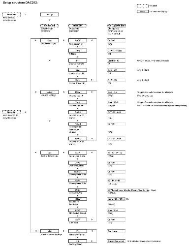

Power on the DAC212 and you're greeted with "DAC 212" flashing across the matrix display before settling on current input.  You may also notice the sound of a relay clicking a few times, another nice design touch - this is a self-cleaning function to avoid build-up of corrosion on the relays.
The DAC212's menu system is navigated via the remote & can be tricky to follow. It's also easy to inadvertently mute the device when leaving the menu as the mute button doubles up as menu entry/exit via a long press.  The DiDiT guys are well aware and will be revising the menu navigation in an update soon.  Currently, the menu consists of nested categories with a number of options available including quite a few that take advantage of the ESS9018 features.  These include serial data mode selection, slow/fast rolloff speed, OSF filter, de-emphasis filter and more.  If you like to tweak your digital decoding then there's plenty here to play with. There are also comprehensive volume settings available in the menu, allowing you to specify custom default volume levels for each input.  You can also choose between pre-amp (variable) and DAC (fixed) output modes - essentially, the DAC212 is a decoding pre-amp with a headphone amplifier included. Finally, this is also where you select settings for the matrix display - intensity, timeout and auto-brightness ranges.
The thoughtful touches keep coming - soft muting: pressing the mute button on the remote swiftly but gradually reduces the volume, and again gradually increases it back to normal levels when un-muted. Whilst not absolutely required, it's small touches like this that make the DAC212 a real pleasure to operate and give you the feeling that someone really thought about this stuff.

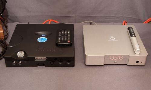

Chord Hugo TT
As I mentioned in the introduction, I've been lucky enough to have the Chord Hugo TT here for eight weeks alongside the DAC212. These two devices have a similar retail price and form factor and I've been very interested to compare them.  All my critical listening has been with volume matched output using JRiver 20 configured with two zones, one for each DAC. That way I can switch immediately between them on the same track. For listening via an external amplifier (my Luxman SQ507X), I use the same method but also with a Mapletree Audio Line Router to flip DAC inputs to the amp, again instant A/B listening.
Let's be honest, at this level in the DAC market (in my experience) we're not talking night & day differences. If that's what we're hearing then either someone has a new wonder-product or someone else has done something very wrong. Or it's in our own head.  Having said that, throughout this process I have tried to be as objective as possible. There was no DBT involved, just a lot of time spent flicking between A and B whilst listening to familiar music. For stretches of time I also forgot about comparisons and just sat back to simply enjoy the music. Sometimes I find a device can grow on you that way even if you don't hear significant differences during critical listening.
Cutting to the chase, I did hear differences between the Hugo TT and the DAC212, leading me to prefer the latter.  To my ears, the most obvious difference is that the TT just doesn't have the resolving capability of the DiDiT unit, nor the transparency.  Where I hear a clean, detailed sound with the DAC212, the TT can sometimes introduce some harshness in the highs and some looseness in the bass and mid-bass.  Again, we're talking small differences here, but at this level that's what we have to work with. I also felt the TT had a tendency to sound comparatively less precise at higher volumes through the on-board amp, almost as if sufficient power output to the HE-560 was an issue. I also didn't feel it had quite the same snap/attack on the leading edge of notes, resulting in a slightly less exciting presentation. Oh, and at this point I should mention that neither amp stage could effectively drive an HE-6 to a satisfactory level without clipping - they would definitely require an off-board amp for that.
Listening to the DACs via line-out to a vintage Luxman SQ507X (early 1970's) transistor amplifier, the differences were harder to identify. The Luxman has it's original components and retains a tube-like character which smooths over some details and gives a slightly thicker presentation. Both DACs provided an enjoyable listen on in this configuration, although the TT doesn't appear to offer a fixed output. It was easy to introduce huge distortion by increasing the TT's volume even in line-out mode.  It's clearly capable of outputting quite a high voltage through it's line level output and this easily overwhelmed the Luxman's inputs. Obviously the message is...don't touch the Hugo's volume control when using it's line-out.
So, I clearly preferred the sonics of the DAC212, how about the design, build & operation? I realise I'm going to sound like I'm really bashing the TT, but I struggled to get along with it's "unique" design. Now, I must applaud Chord for taking aesthetics in a different direction.  Some people will love it, and that's great.  In a sea of boring black & silver boxes, Chord's funky, organic design is to be welcomed.  For me, I wanted to love it, I really did, but there were just too many annoyances in the TT's chassis and interface design for me to ignore.

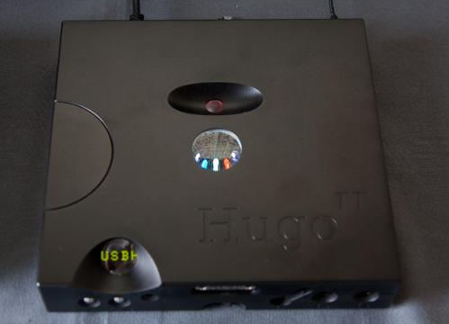

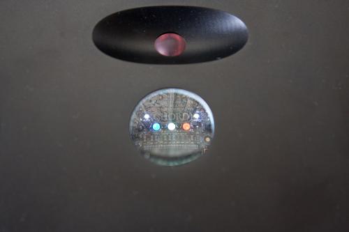

First up, rather than being milled from a single block of aluminium as per the DAC212, the TT chassis is made up of two split halves with the join right around the middle of the unit. I can't quite believe they did this as, to my eyes, this join absolutely ruins the aesthetic of the (otherwise quite funky) chassis.  I can only hope this is a pre-production model, but judging by the original Hugo, I doubt it. That alone is enough to turn me off at this price, but I also found the hard crossfeed and input buttons felt cheap and wobbly.
The volume control caused much scratching of heads at the Head-Fi meet.  For those unfamiliar with it, that recessed round glass ball to the north of the window is the volume control. As you rotate the ball, the led behind it changes colour to show where the volume is at. Making the lowest volume light up red and highest light up white seemed back to front for a few who tried it at the meet, and the non-intuitive direction of vol + and vol - also caught some of us out. These are things you'd get used to over time, but just seem a bit off to me. My final design gripe is the display, which is partially covered by the chassis cut-out so that you can't actually read the whole thing (see the picture above). The geek in me does, however, like the window that reveals the Spartan 6 FPGA chip, although despite trying to learn what all those led colours meant I never did quite remember them all.
On the plus side, the Chord has bluetooth APT-X compatibility (DiDiT are working on adding bluetooth into their production units), and of course it also has that big battery that allows you to run it off the grid for a good few hours (at least six in my testing). It strikes me that the battery is of less use in a desktop form factor like this compared to the portable Hugo, but it was cool to be able to move it around the house for temporary listening away from my desk.
