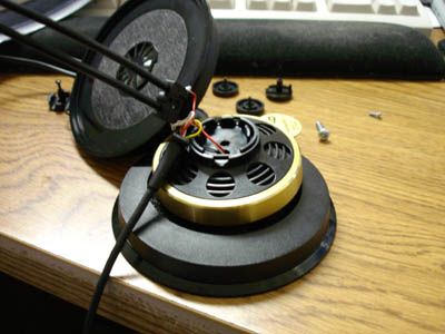

There are no screws on the cans, and I had to take a moment and figure out how to open it up. I took a small jewelers screwdriver and pried off the akg logo and hidden under was a screw under some glue, after then and 10 more screws and everything totally disassembled, I found the terminal points.

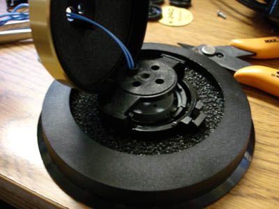

the inside the headband seems to act as a conductor there are terminal points at the tips of the head band, pretty spiffy, I didnt find any wire used to bridge over to the other side.
You thought I was kidding about taking it apart didn you?

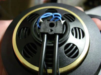

the blue wires are the new replacements
