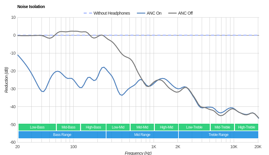

Based on my research on the rtings.com website, looks like what I need is a Sony WH-1000XM3 if I want to have an over-ear headphone - see attached
@ Castleofargh, thank you again for the website :)
Kelvin

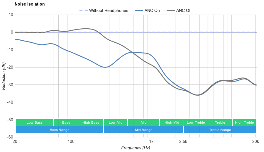

Well I tried one, the one I have is the AT ANC-7b see below:
Compared to the new Sony
16dB difference @ 30Hz
23dB difference @ 40Hz
15dB difference @ 60Hz
16dB difference @ 100Hz
200Hz-300Hz better but not by much
18dB difference @ 400Hz
19dB difference @ 500Hz
16dB difference @ 600Hz
15dB difference @ 1kHz
Knowing that to the human ear, 10dB difference translate to twice as loud, 15dB of noise reduction should be a quite significant difference
