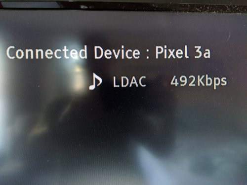

So this isn't news to me, but it may be to some. Not all Android phones that support LDAC will stream it at the maximum bitrate of 990kbps.
I have a Sony soundbar that supports LDAC and will show on my TV what bitrate it is receiving. With both phones left at "best effort" in the developer settings, the OnePlus 7T will stream at up to 990, while the Pixel 3a will do 660 at best, but will prefer to sit at 492kbps even if the two devices are right next to each other. Both phones are running their latest updates and are on Android 10.
If you try to force the 3a to the best quality setting of 990, it does nothing. It's like it's stuck at best effort and prefers connection quality over sound quality.
The OnePlus 6T behaves the same as the 7T as well.
Good to know there are phones that can actually stream at 990 The Oneplus 7T has been on my short list of phones for when I finally upgrade my phone. My S9 struggles to stream via LDAC to my ES100 at anything other than "best effort" and becomes unusable if I try to force higher quality (constant stuttering like a badly scratched cd). I was never too sure if it was due to the phone or the ES100 but this confirms my suspicion that it really may depend on the phone.
I had an S9+ like 4 phones ago and it sometimes had trouble streaming without hiccups when forcing best quality to a Sony WH-1000XM2. I didn't have an ES100 at the time. I've only had this 7T for a few hours, but so far so good. No complaints yet.
The connection between the 3a and the ES100 or Galaxy Buds was as perfect as can be, and never once had a single hiccup. Hopefully the 7T does as well while at the same time streaming LDAC at 990.
I'm not sure how much this matters when I'm only using Google Play Music which is 320kbps AAC, but whatever. Google Play Music sounds fine so I guess I'd just like to know that the Bluetooth isn't the weakest link. I tried a free month of Amazon Music Unlimited HD, but I had a few complaints with it. I couldn't hear a noticeable difference anyway, but that was with the Pixel 3a streaming Bluetooth at 492-600kbps.
