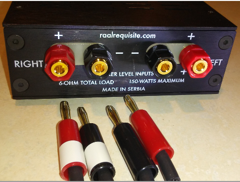

Here's the actual headphones with the cable that shipped with them. The interface box a bit different from the usual one in photos as well.
Just noticed how the rear of your interface varies from mine as well. Mine is like this;
