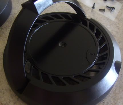

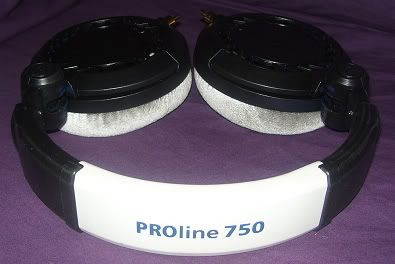

heres some imagery
i still have yet to make the cables, seems no one wants to help me on that part.
PRLINES IN PIECES
VIVA LA (DIODES, mybad)
Proline 2500's in disguise. (i decided they sounded better like this)
May 27, 2007 at 5:41 AM Post #9 of 66
Looking good! I like that black; it makes them look a little like Edition 9.
What's up with those earcups, though? Those vents belong on the 2500, not the 750! Were they hidden under the decals on the outside?
Good luck on the cable front!
May 27, 2007 at 2:59 PM Post #10 of 66
yeah, when you pull the donut sticker off, you can see the vents, but they are still closed. when you pull the bufferboard off, theres are black rings covering the vents, these are glued on with a very strong glue, i bent an exacto knife to kind of pry the cover off of the ports.
i even had to redrill through the cups for the RCA plugs. im pretty sure rca will be fine, as the sleeve is a ground. so the vast erea of connectivity shouldnt really matte rmuch should it?
if you think rca will be much of a proble, let me know while i can still pull them out.
