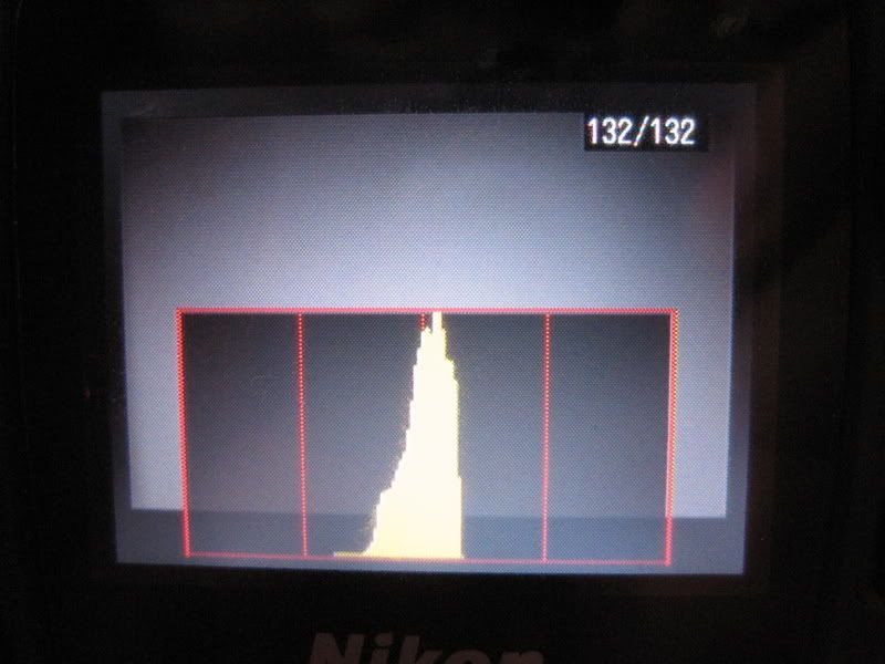

I made an 18% grey card using photoshop, setting the color to 18% CMYK, filled a 4X6" frame and had it developed using kodak royal paper - matt. It was actually developed from Walmart.
This is what 18% gray should show on histogram - middle ground:
Here's what I got from the DIY card:
and here's how I measured it:
Yes the picture is slightly crooked, and it does affect the reflection a little but there's no significant difference! My camera meter was jumping around 1/3 shutter speed, so you do get 1/3 stop accuracy with the card depending on how crooked it is :P. All for 20 cents, perfect for poor people like me.

Actually I think people are getting too "serious" about the developer's end. It is really simple:
1) Picture #1 shows the correct exposure you should get for 18% grey on a histogram
2) Picture #2 shows the exposure measured with the 18% grey card and the historgram shows a similar exposure as an 18% should be
3) Grey card is accurate.
so, go develop some cards, and start measuring, and you will know if the developer did something to skew the color, or the color is faithful and how it should be. My local Walmart did a great job.
