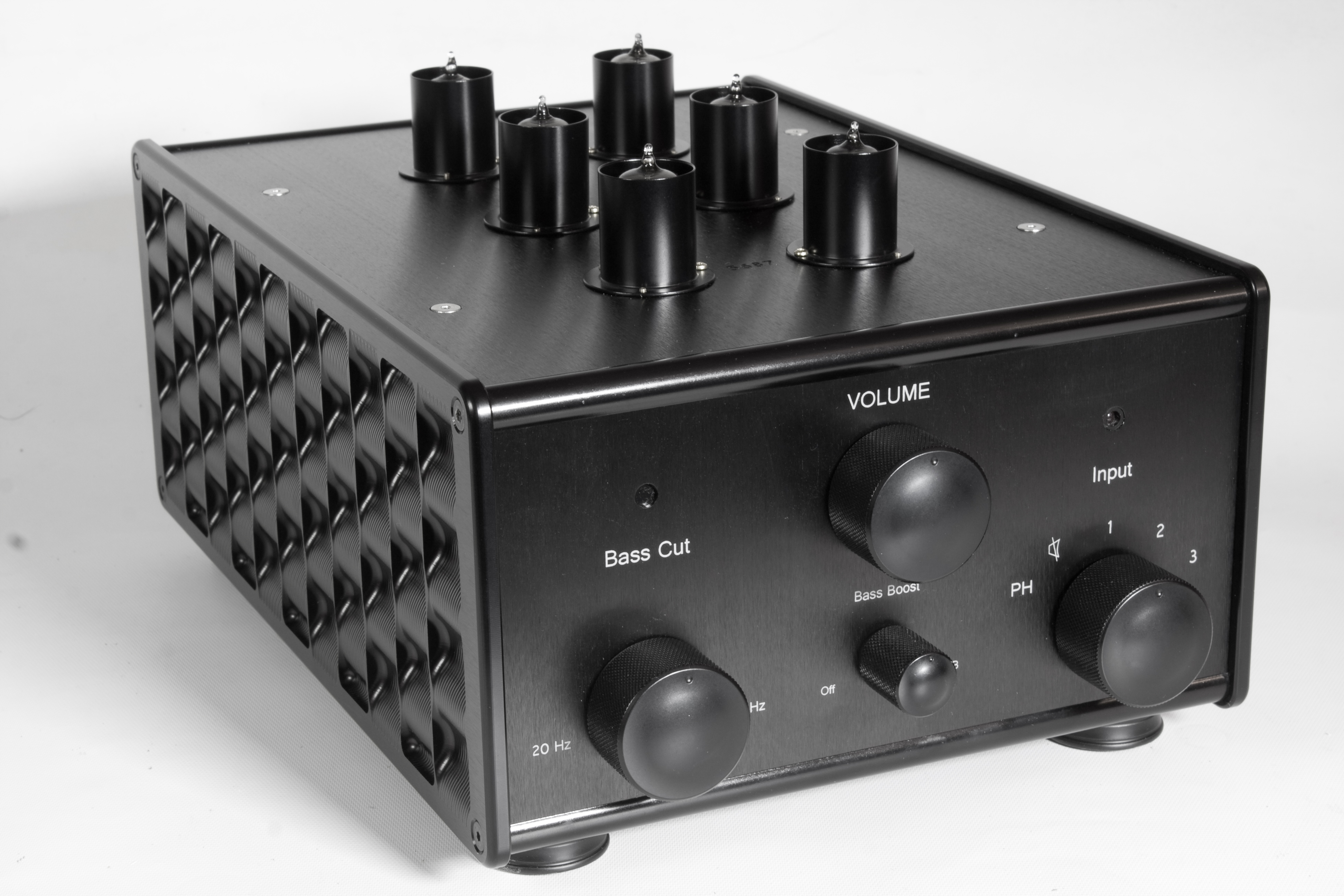

Now I need to find a decent Phono-Pre to connect to my Thorend TD160 equiped with a MM Shure V15 III cartridge !
I am considering this Coffman G1. Has someone heard it ?
