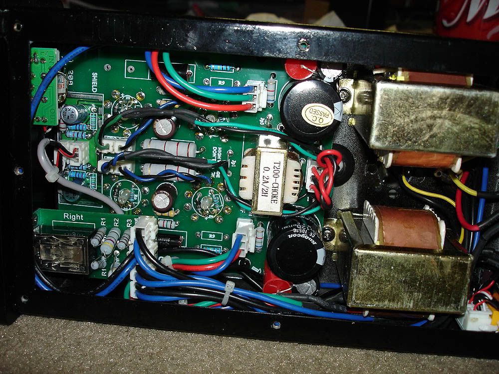

hey could you please give a quick review on this timester t-200?? i am looking forward to get one but don't know how good this amp is. Some internal picture would be nice.
