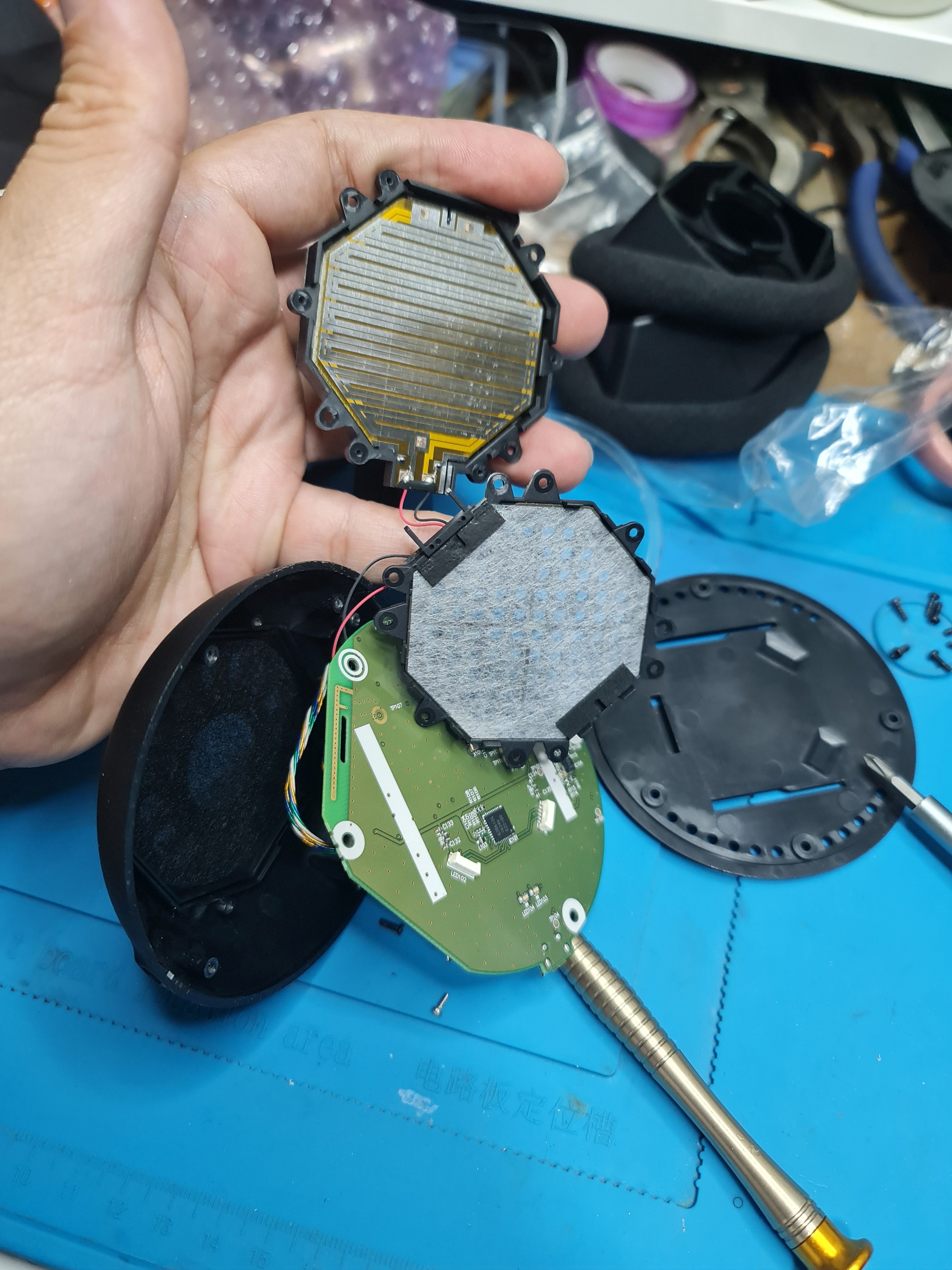

Damped my hp1 today. 100% wool thin felt on the back of the driver, blue tack on the back of the cup, thicker lighter 100% wool felt on top of the blue tack and the original foam in between the two felt disks. I added also 4 microporous reflection disks directly on the back of the driver under the felt and sealed the driver with blue tack against the baffle. I managed to leave the original pads in place as they are in excellent conditions. The thick felt I'm using has very low density and is covering the vent felts too.
Nice result so far with the only major casualty of that little bit of ss that was there originally.
Way much better than stock. Still the mid low honk doesn't seem to be tamed and I would like to extend the HF a little bit higher. Anyone having suggestions about it? Somebody is a specialist about reflection dots? Is it better to use more sealing and reflective material for them (e.g. copper tape). Any specific reflection dots pattern that worked best for you with this headphone? I want to act only on the rolloff keeping the rest of the hf at the same level as they mingle beatifully wit the mids. Is there a relation between the dimension of the dots and the reflected frequency?
I've ordered already some fish foam 2cm thick to replace the original one.
Also is there a final consensus about the value of recabling this can? My usual way would be mogami with nylon sleeves.
Thanks to everybody.

Antistase, the low mids honk sounds like they're still slightly under damped.  What material are the microporous disks?  Are the 3M Micropore tape?  If so, you may need to cover more of the back of the driver with it, or try denser felt.  I can't suggest anything for the treble.  My HF hearing is good for a 51 year old, but it's not all there anymore.

Not sure what you mean by "mid-low honk", but if by that you mean that there's a lump in the midbass where it meets the midrange, you might need to use denser felt right behind the driver-- ie, you may need to increase the amount of damping. Always get this part right before you take care of anything else, even the top end.
Which brings us to reflex dots, but let's use the euphemism "reflection discs". To answer your question, yes, the effect of a reflection disc is very much dependent on its size.
Reflection discs have become anathema in some quarters, so prepare to be shunned if you use them. Their use was originally intended to prop up only the top two octaves (5k to 20k). The theory goes like this: A disc of a certain diameter will let sound wavelengths greater than that diameter diffract, or bend, around the disc. Wavelengths shorter than the diameter of the disc will reflect back, adding to the original sound, since the reflection point is virtually on the diaphragm itself. In real life there's no sharp cutoff-- as frequency rises from the bass, a reflector disc will reflect nothing, then a little, then there will be a more sudden increase around the point where the sound wavelength matches the diameter of the disc, then back to a gradual rise to a shelf or plateau after that. In speakers there's an analogous (but reverse) phenomenon called the "baffle step".
Or in ballet, the pas de baffle. But that's not important now.
By combining porous tape (MicroPore, TransPore) with felt, you might be able to make a reflector large enough to reach down to the point where the dreaded Ortho Droop begins (according to Yamaha's response graphs, this could be as low as 1kHz !) without sealing the driver and creating a tweeter. And to do this right, you'll want to experiment with several disc sizes. Try a whole bunch of little ones. Or one big one (maybe 19mm or so) smack in the middle. Then add a circle of little ones orbiting around the big one. Since the ear is not omnidirectional at all frequencies, some experimentation (and research) is in order, because it may be possible to cheat. I love it when that happens.
Of course, since the traditional treble control hinges at about 1kHz, you might just want to take the easy way out and do the correction electronically. It's only about a 3dB/octave slope, so nothing radical is needed.
