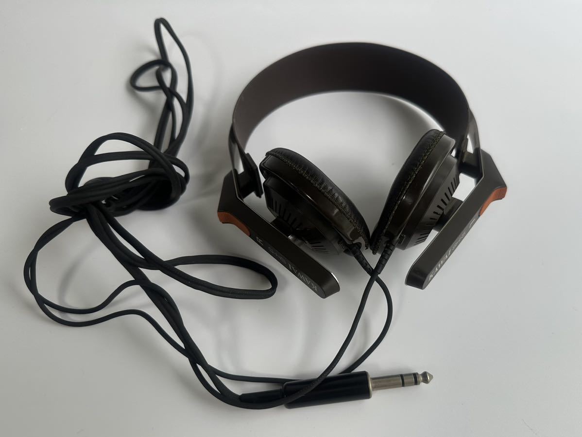

I wonder why Akai used completely different magnets on the front and back side of their ASE40 orthodynamic. Ideas, anyone?
Are there pictures of that?  Sounds interesting, but I couldn't find anything via google or wiki.
Yeah, let's see a photo. The only plausible reasons I can think of are the ones Sambones has already flung, or variations thereof. Of course, maybe they ran out of Type 1 magnets and just got in a shipment of Type 1As.
aha, i think this is the right time discuss about this one...is it identical or not, with Victor HP D-50 that i posted before ?
http://www.head-fi.org/forum/thread/111193/orthodynamic-roundup/16455#post_7284905
more info:
http://wiki.faust3d.com/wiki/index.php?title=Victor_HP-D50
http://wiki.faust3d.com/wiki/index.php?title=Akai_ASE-40-J
