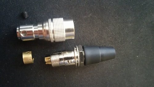

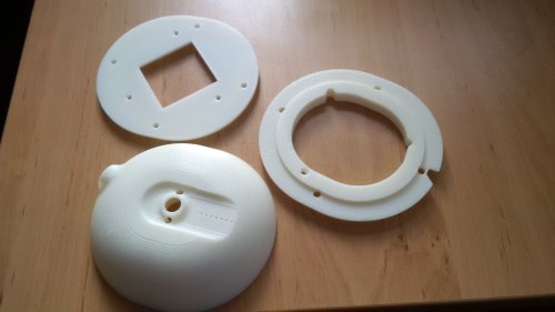

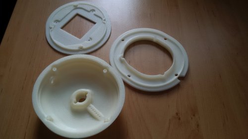

I finally have my cups printed, I am really surprised by the quality of the 3D printer at my university :D
(metallic black finish inc)
I was afraid that screw holes may not print well, but this is awesome :)
Wasn´t so lucky with waveguides tho :D I guess it is enough for testing now.
Also my Hirose connectors arrived! These looks and feels lovely! (the rubber thingy is there just to protect the pins now..)
Just waiting for Ag/Co cables from PAPRI audio to arrive so I can start :)
Just one question: The gold ring is supposed to secure the cables and end up in line with the screw like I have them lined now?
Wow, that 3d printer must be very impressive! What kind of filament did it use?
Since your cups are way better than my current ones, what price would you name if I may have you print some for me(just the left and right cups, not the baffle and rings)?
As for the gold ring, I did the same thing as you suggested, so it should work.
