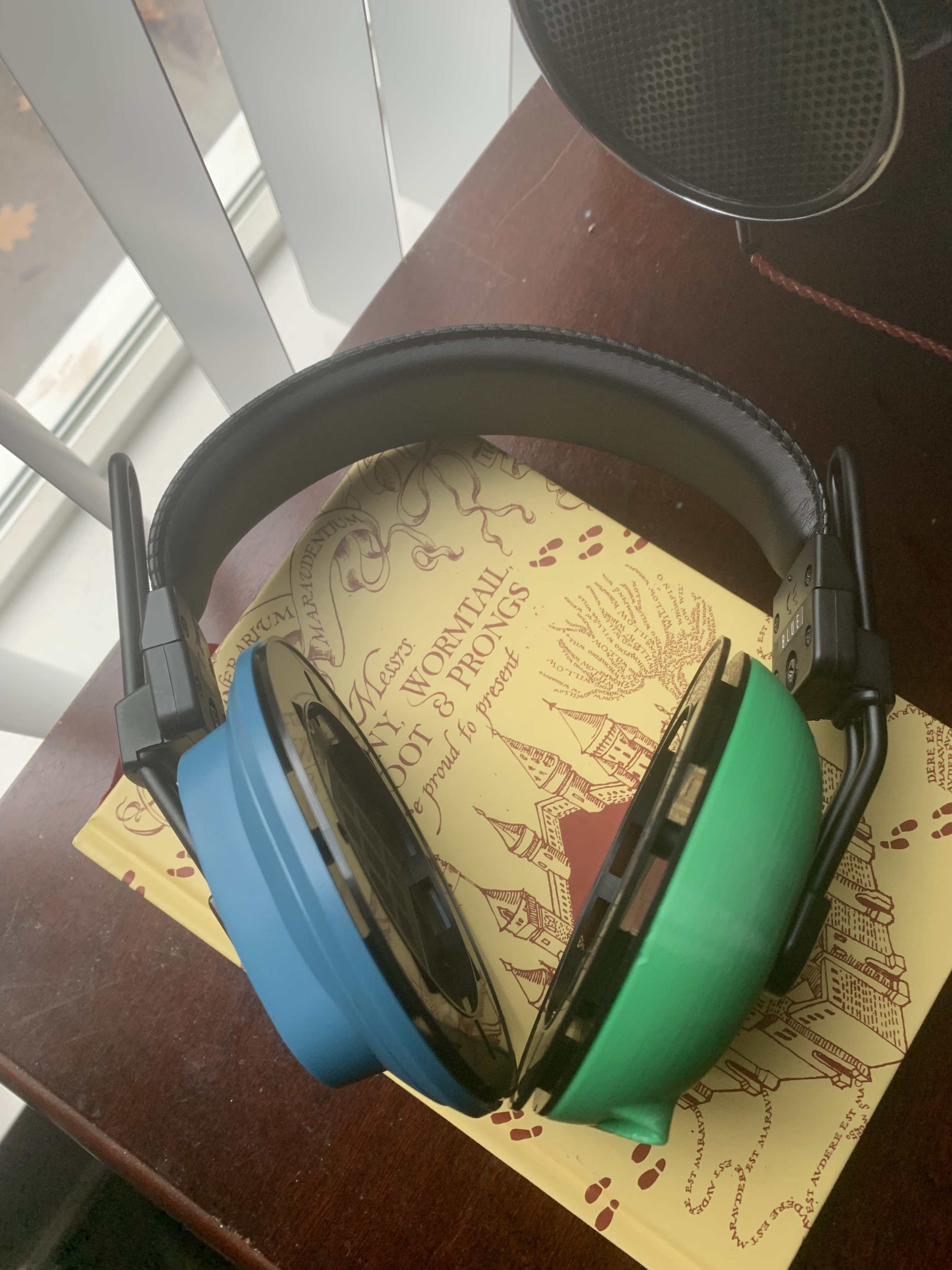

At this point, you are essentially done.  Tuning the headphone is easy enough, just remove the baffle to change internal damping materials, or cover the bass vents/insert small screws to tune and balance bass.  IMPORTANT NOTE:  3D printed plastic is quite tough, however screw holes can vary in strength depending on your printer.  Tuning requires repetitive opening and closing of the parts, and care is required to ensure screw holes do not strip.
