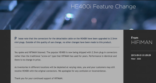

Could they have made the change when they moved to the standard 2.5 connectors instead of the smc? Do we have any pics of 2.5 connector versions that still have the backplate?
Dec 14, 2015 at 12:16 PM Post #6 of 69
this is my thought as well, but have only seen a couple of pictures.  Part of why I started this thread.  Weird that they made a big deal of the connectors, but, you know, didn't even mention probably the single largest sonic change you can make on a planar  other than the actual driver.  This is like the grill mod X100000 in sonic impact, haha.

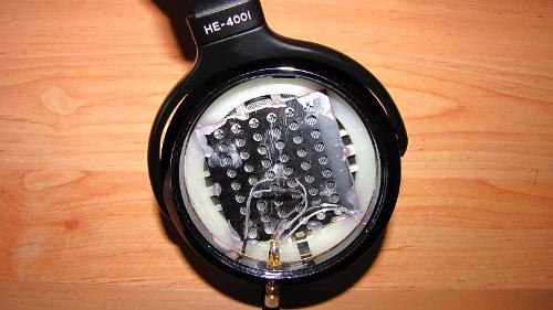

  i have the old connector (SMC) and mine looks like this:
took the picture from google.
yeah, so looks like the exact same 7 magnet array (magnets are underneath the back plate between the rows of circular cutouts), even the same plastic mount.  Mine just doesn't have the backplate.  Also in the process of researching this I realized the HE560 has a 9 magnet array.  The HE400s and HE400i both have 7 magnet arrays.
All I can think is that when they started making the 400i, they decided to play it safe and use a backing plate, but as they had more time to test it, they realized the 7 magnet array, even on the stronger magnet HE400i, didn't need a backplate.  My headphone is also about 8-10 grams lighter than the stated weight of the HE400i as well.
