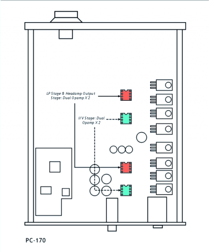

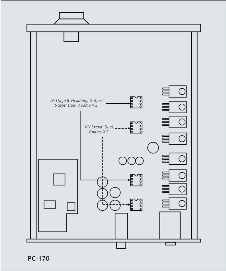

I don't see it this way, Ren. I'll post again the opamps arrangement:
And a very good single-to-dual DIP8 adapter board with sockets pre-installed: https://www.cimarrontechnology.com/browndog-021001-single-to-dual-op-amp-adapter. Of course, you could find similar adapter on eBay at a fraction of the price, just not sure about the quality (perhaps with DYI this can be done better and cheaper than eBay). Now it might worth doing some measurements prior to purchasing these adapters, because I'm not sure will perfectly fit inside the PLAYMATE.
However, what's really important is that combining the same socket for I/V and LPF makes this the shortest audio path possible, so I only see a highlight here.
So I have 2 muses 8920 and 2 v6 vivids - what would be the optimal arrangement going from back of Playmate to front?
Feb 3, 2019 at 10:56 AM Post #176 of 602
You should try yourself and see what combination you like most.
As long as you put them in pairs - 2x same model in I/V (green) and 2x same model in LPF/Gain (red) - it will be no problem.
I found the fact that Playmate use 4 dual OP-AMP's a good thing. It's more easy to change them than having duals and singles in the same unit.
Hi Raoul,
I understand your take...but the fact is the I'V needs the same opamps as does the LP and Headphone.. I know I will not be using singles on an adapter to separate the LP from the Headphone.
Ren
Hi Eiffel,
Agreed on the mixing of singles and duals.
Ren
