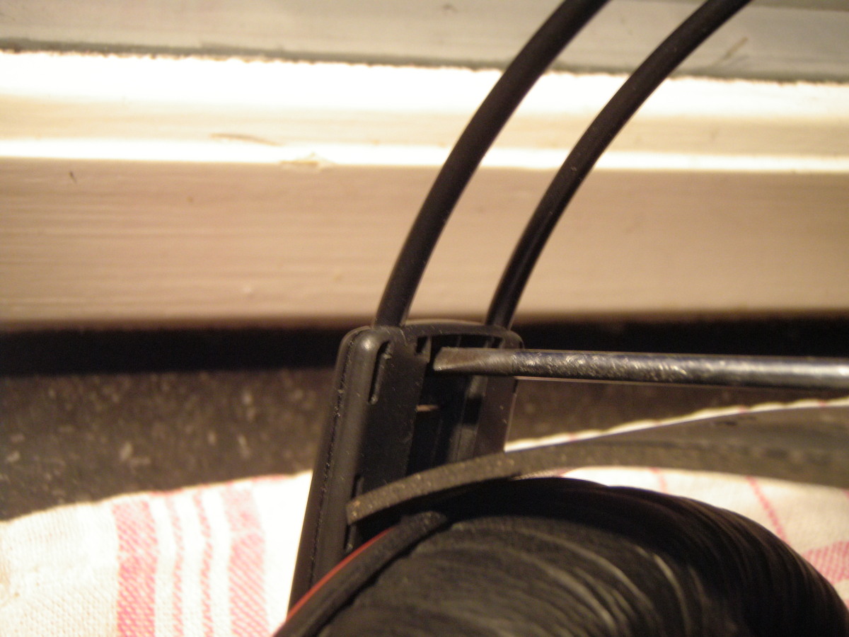

So, I found the manual from AKG with instructions on how to dismantle the K301:
http://www.akg.com/mediendatenbank2/psfile/datei/20/k100_200_34055d23d12c1d.pdf
The infamous AKG elastics were dying of old age so I took some photos changing them.
First step is to open the cups. Use a screw driver or similar tool and press the latch from the inside, at the same time pulling the cap downwards:
Should come off with some push and pull.
Then it's only to cut the rivet end and old elastic off and tie some new elastic around the rivet. Old elastic:
