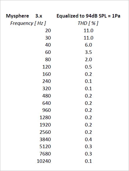

No, Heinz! Like others (as it seems) I'm just interested in the distortion figures after equalizing down to 20 Hz at normal listening levels.
To explain my concern a bit further: My HD 800 responds extremely well to equalizing, which effectively lifts it two classes higher. The same doesn't seem to apply for the HD 800 S according to Inner Fidelity's Tyll Hertsens – due to its higher THD level at low frequencies reaching up to ~7.5%, and this at 100 dB (!). So the Mysphere with its THD of almost 10% at ultra-low frequencies already at 90 dB (!) is a candidate for being less suited for equalizing the lowest octave. Of course I'm hoping for the opposite.
Oh! Understood your request now... :L3000:
BUT: As others already wrote, Human do not recognize distortions well coming from low frequencies....That's just a reminder that those effects should be tried and not interpreted potentially wrong using tables only. Also it's big difference if we talk about K2 or K3 because: asymmetric distortions does not pain human much (example a violin), but symmetric distortion are not welcome and mostly annoying.
So what I suggest is:
I create a table applying using Mysphere 3.1 the requested voltage so, that at all frequencies on the artificial ear it reach 1 PA (~94dBSPL] - the corresponding K2 + K3 will be listed.
Would this be fine for you?
BR heinz

Yes, Heinz, and that's more than I would have expected.
And to make it clear: My concern shouldn't be read as a criticism – far from it! I absolutely understand the technical and physical problems of a completely open system like the Mysphere, as well as the advantages.

Hi - now here is the list of THD values in case the Mysphere 3.1 would be equalized to 94dB SPL ~ 1Pa at all frequencies: (the measurement is made on artificial ear simulating typical human ears - whatever this mean :wink:

Thanks, Heinz! It looks good – as if it can be done.
