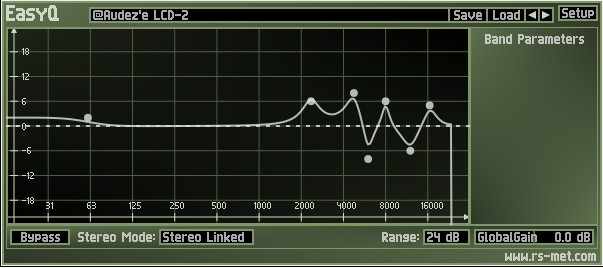

Here are my EQ curves for my main full-sized headphones (I didn't bother with the rest that I never use, and the EQ curves for the IEMs are posted in the link above):
LCD-2 - I don't normally EQ the LCD-2 for casual gaming or movie watching, but if I'm being a bit more critical, like for leisure listening or audio production, I would use this EQ curve (updated 2011-11-27):
This curve fills in the recess in the mids of the LCD-2 (for exmaple, it lacks the proper bite on musical materials with distorted guitars, brass sections), adds a little bit more definition in the treble, and restores the slight drop off of bass in the sub-bass region. Essentially, this curve addresses the issue of the LCD-2 being a bit dark in some people's opinion. While it adds some brightness and clarity, it absolutely does not make it fatiguing or excessively bright in any way (which is big pet peeve of mine. I hate ear-bleeding brightness), and IMO, strikes the perfect balance for my ideal sonic signature.
Since all LCD-2's are shipped with their individual frequency response graph, you really have to look at mine in order to put the EQ curve into proper context:
The thin white slanted line I drew is basically what’s widely considered the ideal upper-mids to treble response from 1KHz to 20KHz (headphones shouldn’t measure flat in that frequency range, since headphones are different from speakers), and I basically EQ’d the LCD-2 to that ideal (while also using test tones like sine wave at regular frequency intervals, pink noise, and comparison to other headphones and speakers). At this point, I would say my LCD-2 sounds about as good as I need a pair of headphones to sound, and beyond that, it’s just unacceptable diminishing returns.
If you are EQ'ing your LCD-2, don't just copy my EQ settings--you have to look at the measurement graph that came with your LCD-2, and then extrapolate from my EQ setting and my response graph to see WHY and WHERE I EQ'd in order to achieve the white line. Essentially, anything above the white line you want to cut, and anything below he white like you want to boost, so that the end result is as close to the white line as possible. This is more or less true for all headphones, so you can for example, take another headphone's frequency response graph and draw the same white line, and then proceed to tweak the EQ setting to match that ideal frequency response.
