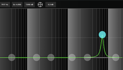

The peaking filter: f = 7,017 Hz, amplitude = 7 dB, Q = 4.0​
I tried it with the Crescent with Comply foam. With most music it’s not that noticeable unless you’re looking for it. At worst, it sounds like some hollow whistling. As for missing sparkle, I’ll take smooth and honest over fake sparkle resulting from the tall resonant peak at 7-8 kHz.
If you look at the response resulting from the Comply tip, you’ll see that it actually has a stronger response from 4 kHz to 12 kHz except for the spike. After 12 kHz, it’s definitely softer. So compared to stock, it’s missing air. But what’s really up there? I can still hear up to 15 kHz clearly, but 16 kHz is faint. When I EQ back that 15 kHz spike, making sure frequencies below 12 kHz aren’t affected by the peaking filter, I don’t hear that much difference with most music.

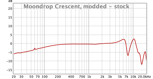

Difference: modded - stock​

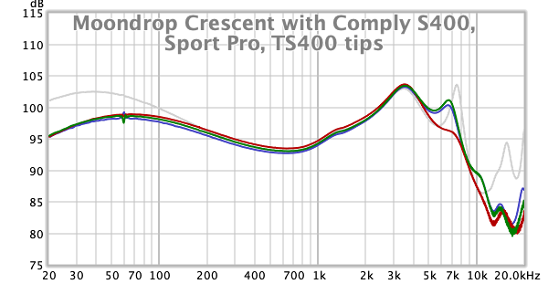

Moondrop Crescent with Comply foam tips, left channel shown
Red: S400
Green: Sport Pro with Smart Core
Blue: TS400 from UE600vi​
The S400 is more durable and washable, and it seems to damp those resonances more aggressively than the others. I also tried the T400:

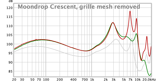

Moondrop Crescent, frequency response with grille mesh removed
Red: Stock tips
Green: Comply S400 tips​
Unlike the Sony MH1, there’s no foam plug in the tube in this one. It’s not hard to place the grill back in front of the tube when you’re done.​
Here’s what I have for Comply foam:
Red: S400
Red: Stock tips
