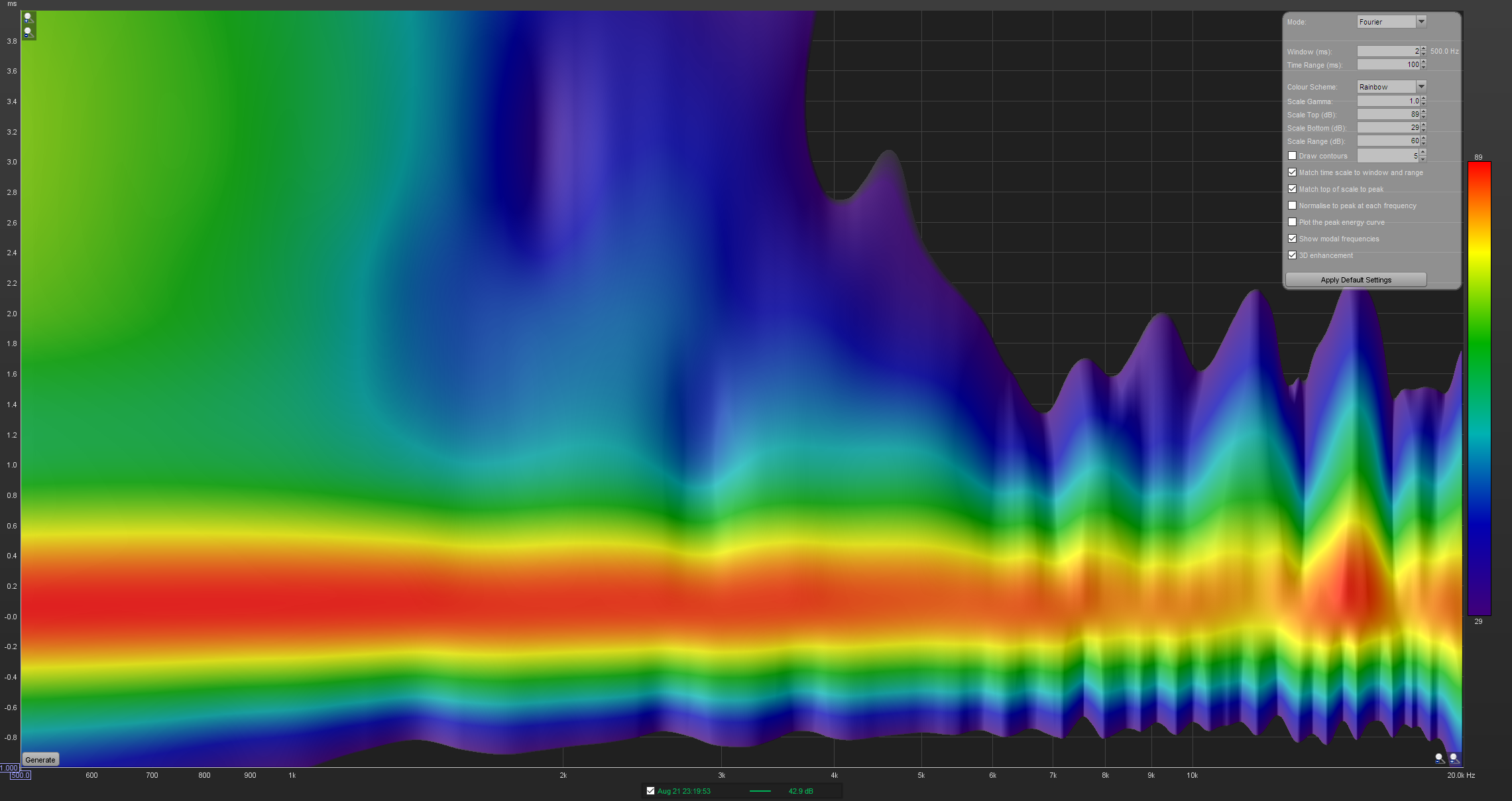

Settings are a little wonky but I get the idea. Thank you! The blue one is quite amazing! Another easier way to show the ortho wall is to do the same with the spectogram
Try these settings:
