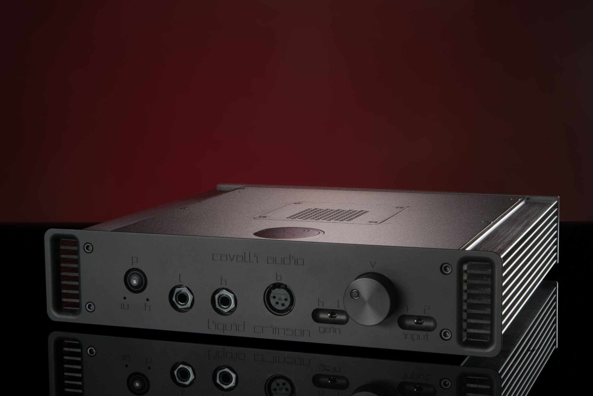

First thing is, let's have a look at the Crimson. It is an embedded hybrid with no coupling caps. It uses 1 triode per channel, hence a single dual triode.
It is SE only with about 4-5W per channel into 50R. It has four supplies: Heater, HV, LV Rails, and Housekeeping.
It has a pretty beefy linear supply using a custom RCore transformer. It is all through hole components except for some housekeeping circuitry like the offset detector.
It uses a custom TKD volume control, Cardas RCA jacks and Neutrik headphone jacks.
It's also pretty big. Here's a photo:
Notice that the sides are entirely heatsinks. These sinks make it possible to make 4-5W SE. The output mosfets are biased at 150mA keeping in class A mode for a very long time as power demand goes up. Each mosfet burns about 5W at idle creating a minimum of 20W that has to get out of the box. There are also hot regulators attached to the heatsinks so let's say 25W.
The Crimson is made on a single board (I can't find the interior photos offhand).
So the engineering question is, how do we take this and turn it from SE to Balanced (which would increase the original size by at least 50%), then take the balanced version and make it 1/4 the size of the SE Crimson, and then get the cost to a more affordable level?? We'll get into that in the next post.
