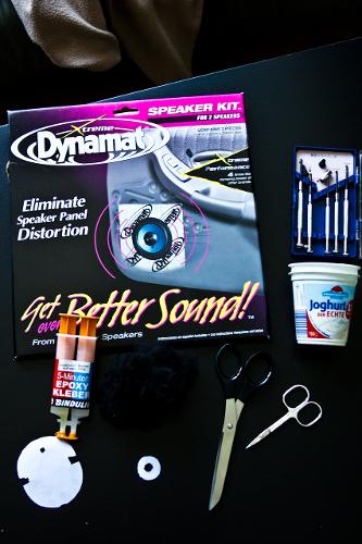

The Goal of my mod is to enhance the deepbass a little bit,to get the bass punchier,to improve the clarity and isolation without spending tons of material and money.Material
You need 4 plastic-yoghurt-cups with a inner diameter of 69mm and an outer diameter of 72-73mm, yoghurt cups with a plastic ring are just perfect !
2-component epoxy
Sound wool/dampening wool
a small and a big scissor
Dynamat Xtreme
Screwdriver
sheet of paper
pen
tissue
1.Step dissambling the headphone & create drawing
At first you have to take off the paddings and open the headphone by removing the 2 screws.Now you'll see the innerside of the Cups. There are 2 more screws which hold the back of the cups in place.
Remove the screws and put the back of the cup on the paper(facing the creative label towards you) and use your pen to create a drawing.
Cut the drawing with you scissor and test if it fits innerside of the back. You might have to make it a bit smaller and add 3 spaces for the plastic spikes inside the headphone.
