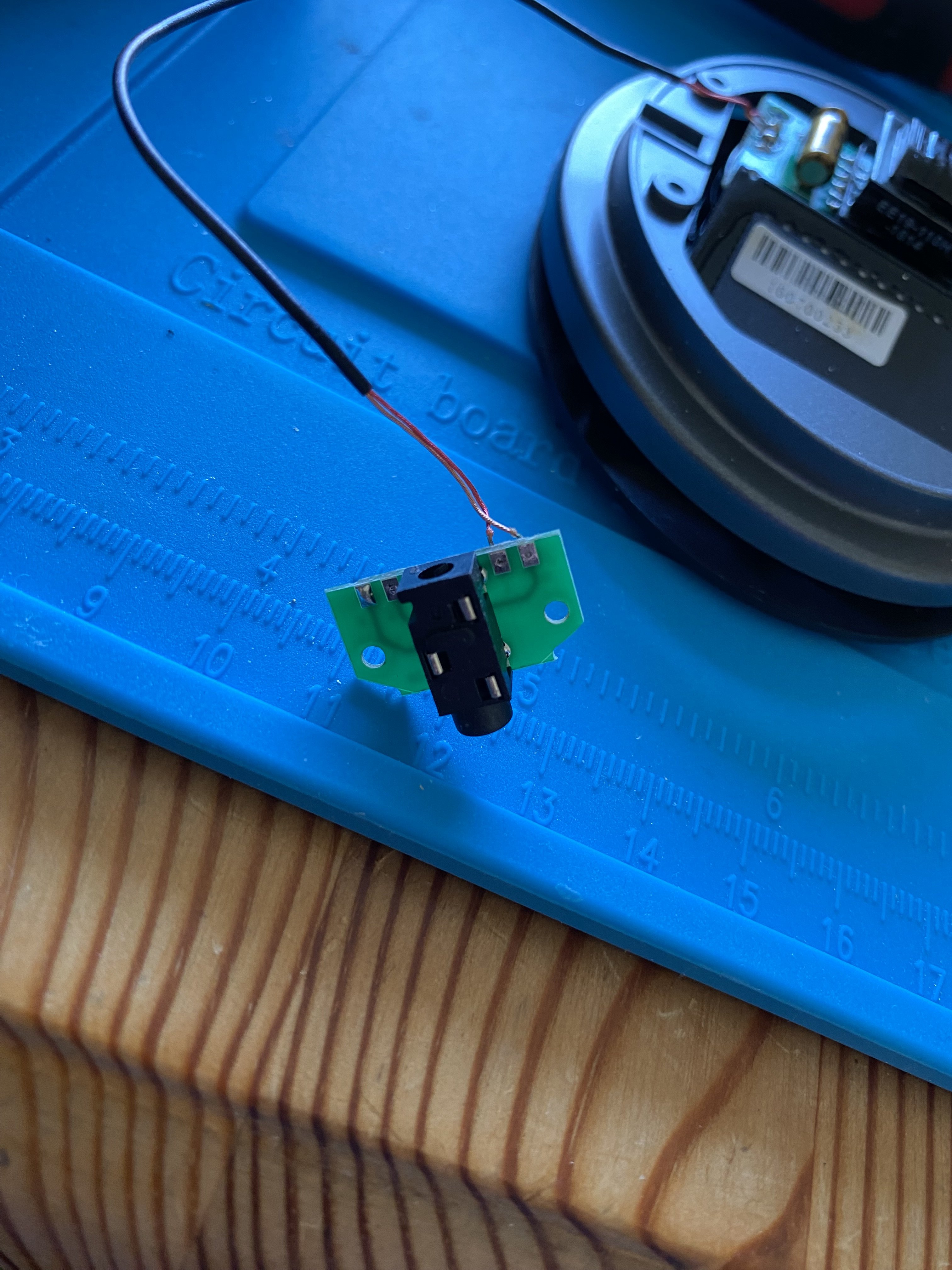

I’ve always been impressed by these unusual headphones, but felt for a number of years they were underperforming. A year or so back I started to lose sound in the left channel which I initially thought was due to a poor contact. Having stripped them down I realised the fault lay with defective traces on the small pcb holding the female 3.5mm socket. I’m a firm believer in hard wiring where possible and this presented an easy solution to my problem. As can be seen the 10uF cap has been upgraded to a Nichicon. Had space not been an issue I would have preferred to have fitted a Wima Polyester but measuring 16x11x7mm there really wasn’t the space without chiselling out some of the Cherry wood cup. The chosen cable measures 125cm including the 45cm yoke and is a twisted weave to combat RFI. I prefer Occ copper for headphone cable as it typically gives warmth to the sound. This cable has higher tensile strength than others I’ve tried. Before closing up I added a small piece of 2mm thickness bitumen to help control reflections and temper any unwelcome resonance which had shown up on a frequency sweep. Since performing the work I’ve only run them for a few hours and on first impressions they sound jaw dropping. The clarity of the upper mids and treble is possibly up there with the best I have ever heard and I’m referring to the Stax Lambda and Sigma. The sound is now incredibly natural, as if I was listening to my Gale 401s and not a pair of headphones. These are now my new Reference phones being streets ahead of my other headphones (Hifiman Ananda/ Nakamichi HF-100/ Beyer DT-811). The JP1s can’t take all the credit as there is wonderful synergy between the Headphones, the modified Graham Slee Novo amp and its new 24Vdc power supply which benefits from 3 levels of filtration. The bank of capacitors do a remarkable job with filtration to provide a totally silent backdrop for the music.
