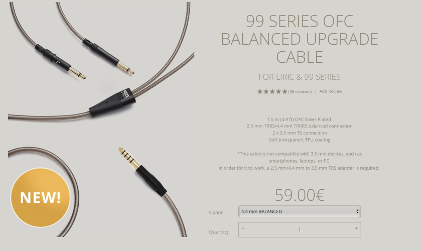

Hi,
I'm looking for a balanced cable for my Hifiman Sundara. Is the - new- Meze 99 OFC Balanced Upgrade cable a real balanced cable and suitable for my headphone? Thanx!

Hello,
No, you can't.
The Sundara has a 3.5 mm plug, the cable from Meze has a 2.5 mm plug so that it can be connected to the headphones.
The plug to connect to the amplifier would fit if you have a Pentacon socket on the amplifier.

Hi,
I don't get your point, it says : 2 x 3,5mm TS connection in the attached announcement.

Yes it works fine with the Sundara’s have the 2.5mm version use an adapter for 4.4mm
Jan 8, 2022 at 7:14 AM Post #10 of 11
Ah okay, then there are probably two cable versions.
One with 2.5 mm and the other with 3.5 mm on a Pentcon plug.
That was a little irritating on the photo.
No, the connectors that go to the headphones are always 3.5mm, those that change are those that are connected to the sound source, 2.5mm or 4.4mm, depending on the needs
