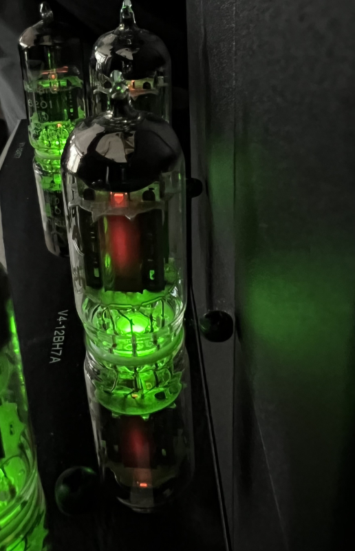

Who can spot the anomaly on this picture?
In the wake of an earlier post on this thread the unit went to McIntosh repair immediately through my favourite hi-fi shop. Thanks to them I was still able to enjoy an MHA200 in a form of a temporary replacement unit during the waiting. Now it is back, all good, one tube had to be replaced.
First newbe question: One tube? Are they not supposed to be matching pairs?
Second thoughts: I am completely new to tube amps. If this is a common issue with possible heavy consequesces, should it not be described in the manual with some illustrations? Are there safety circuits in the MHA200 that could avoid the heavy consequences in case the red plate tube goes off when it is not recognised in advance? (Sorry for the dusty picture, the mash was removed first time after two months of ownership)
Is the anomaly the reddish area on the tube? What is it called when this happens to a tube?
Yes, that is. It is called red plating.
The protective mesh above the tubes also became quite hot, it was uncomfortable to touch, where it is normally just pleasantly warm.
Maybe that is how I have noticed it.

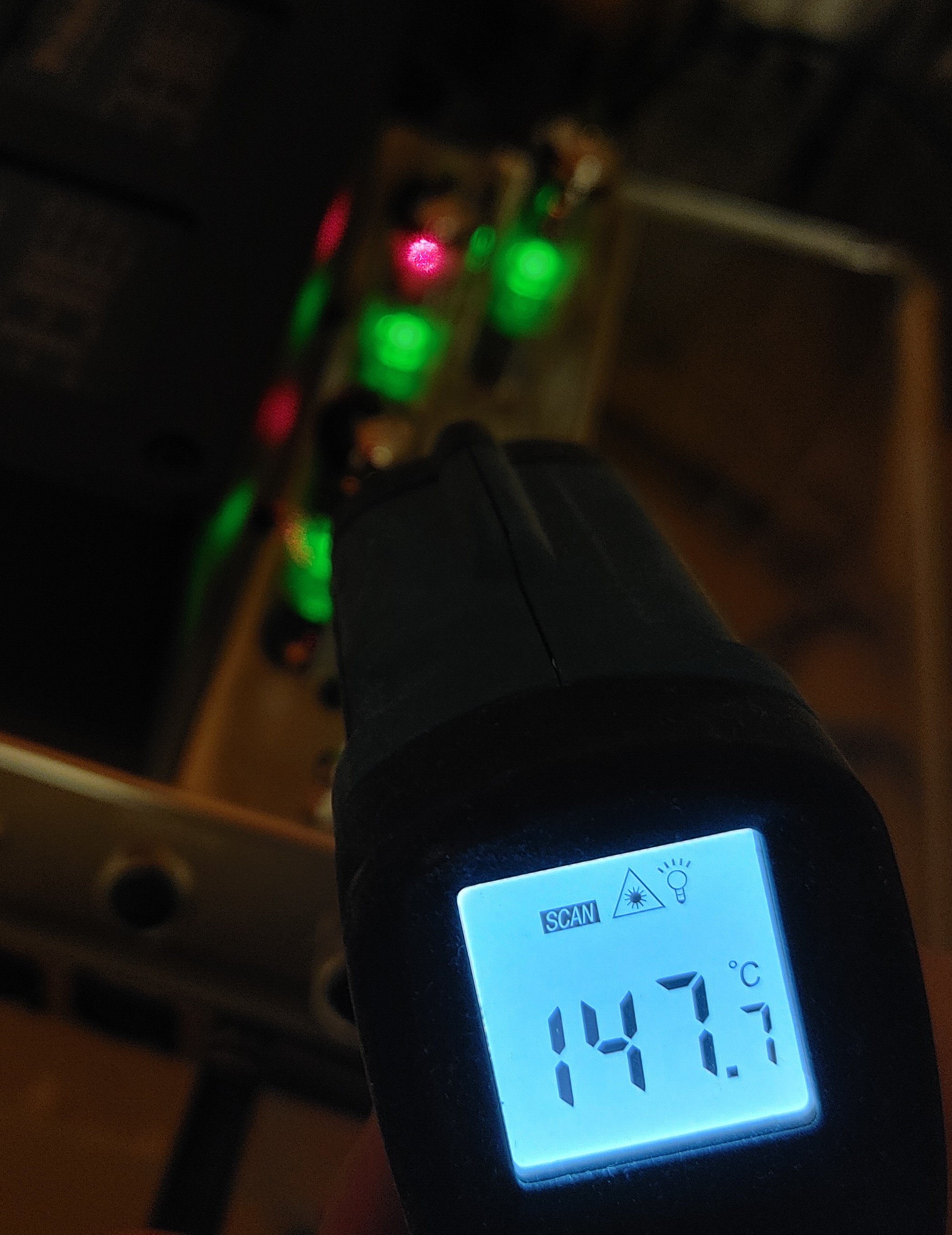

Some fun measurements after removing the mesh:
This is the normal tube. The red dot on the tube is the laser pointer of the temperature scanner.
This is the plate of the red plated tube
This is when I managed to hit the heating wire around the top of the plate with the scanner:
Interesting, thanks for the illustrations and explanation. I had the Ray Samuels Emmeline II “The Raptor” tubed headphone amp and now the McIntosh MHA-200 and have not seen this anomaly yet. Not glad that your tube red plated but good for me to see what it looks like.
