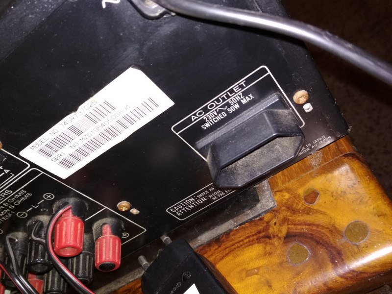

A kind of miracle just happened and my marantz receiver suddenly started remembering stations and settings even if the power cord is completely disconnected from the main power outlet. I really don't know how it got fixed but something cured it's amnesia. :)), These are the strange things that happened and one of these three things have cured it. Now it remembers the stations and i am super happy.
#1. Two days back my wife was meddling with the Marantz Receiver wanting to connect her iPhone via bluetooth. I was such a big lazy ass i didn't want to get off my chair and do it for her so i was instructing her and she was messing around until it started to work with bluetooth.
#2. I moved the whole sound system from my tv room to living room today.
#3. Since the new location doesn't have many sources to power, i figured out the power port in the back of the marantz receiver which miraculously compatible with the Sony Ericcson phone charger adaptor which powers the Ugreen bluetooth receiver. So it's much neater now.
One of above three things have fixed it. Maybe it there was something wrong in the circuit and chips because it wasn't been used for so many years. Since i started using it quiet often since the day i bought for last few months, the memory might have started to work. Thinking of a battery inside which got charged is impossible.
I decided to post this because these information might be useful for someone who is having the same problem as i do in the future.
