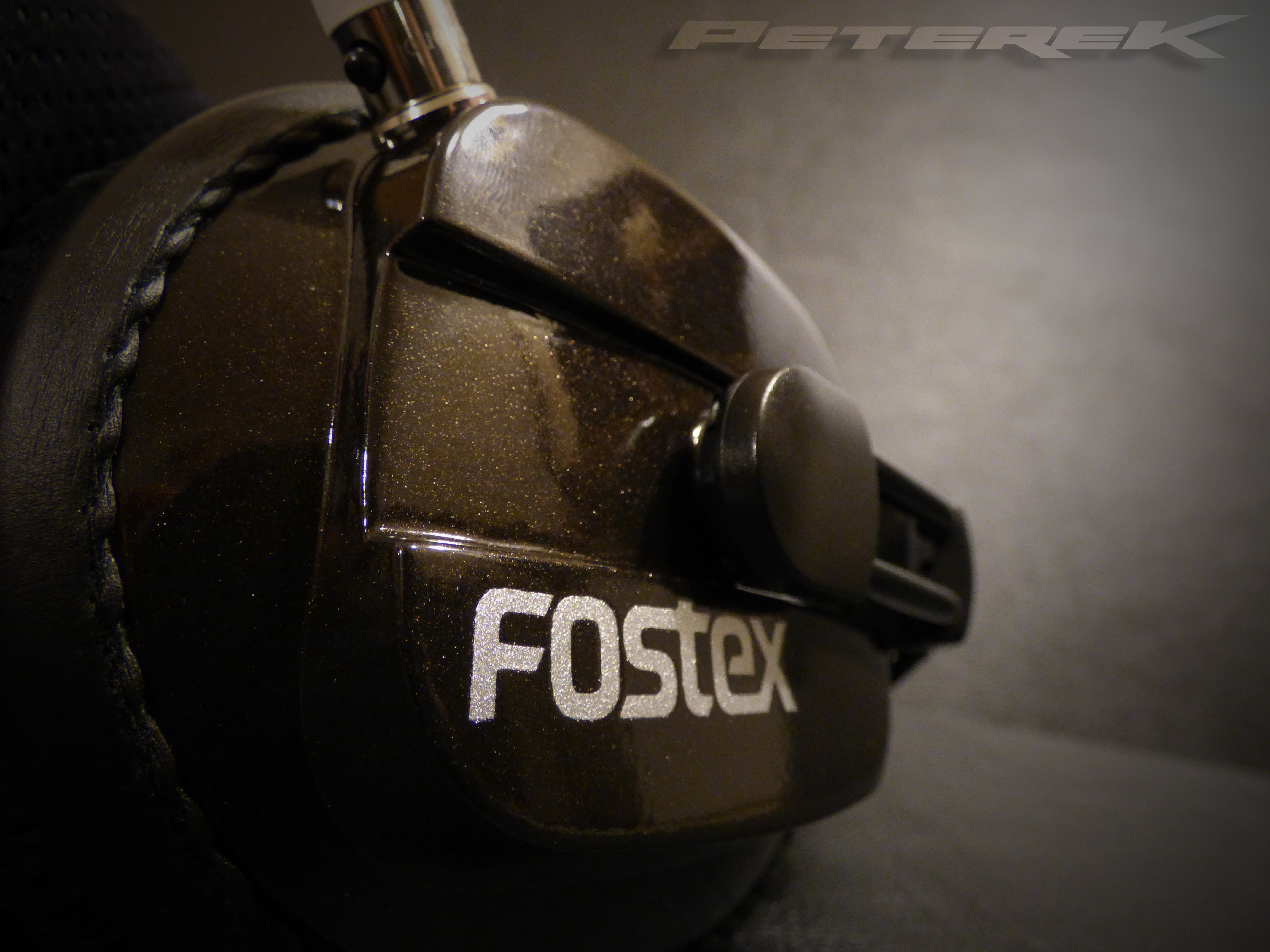

Dec 8, 2015 at 12:38 AM Post #4 of 7
How about just modding a T50RP in it's own housing? You don't have to keep it looking stock, you can get creative.
Dec 8, 2015 at 1:21 PM Post #5 of 7
Wow is that a
WOW. Is that a custom paint job? I do like the idea of modding a T50RP, but I have my eyes on the Alpha Primes and if I end up modding a T50RP itself I might not have a need for the Alphas anymore. It might be too much of an overlap.

That being said, yours is gorgeous!
