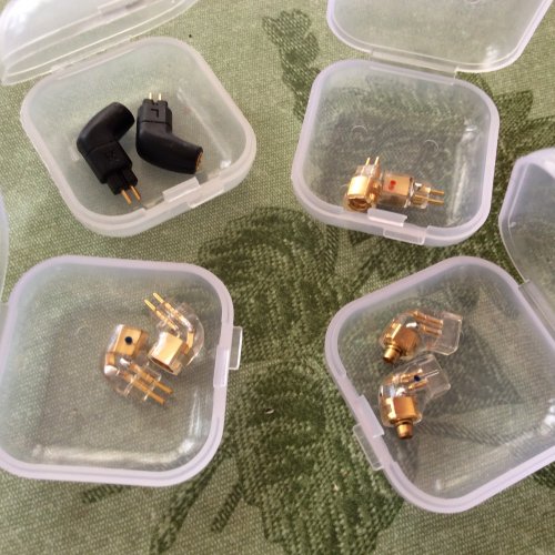

Anyone know of any cables that have an angled .78 2-pin? Look like this
Preferably $100
I second this request... I am looking for the same with a 4.4mm balanced termination. I've scoured AliExpress and can't seem to find anything decent. Anyone?
I tried the $15 dollar trn one off amazon... not impressed.
Guess the problem is that quality cables tend to use better plugs, and metallic plugs use to be straight. So you only find angled plastic plugs in cheap cables.
I can't remember a good quality cable using standard 2pin (not QDC) angled plugs now, sorry.
These adapters could be a solution for some people:
They are a bit high resistance measurements for my taste, but look even at least.
Moon audio are angled as well as 64 audio. I know where the expensive ones are having trouble with the cheaper ones
