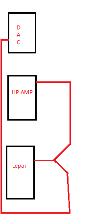

I've come up with a way to split.
lol
Modi hooked up to a aux to 3.5mm male jack hooked into a Y 3.5mm male jack to two 3.5mm female jacks. With the Y male connected to the lapai leaving the second Y female leading to a 3.5mm male jack to aux plugged into the HP amp.
Kinda funky.
Like to some way how have direct line from DAC Y'd off to the lepai and HP amp with strictly aux to aux rca cables.

I've come up with a way to split. lol
Kinda funky. Like to some way how have direct line from DAC Y'd off to the lepai and HP amp with strictly aux to aux rca cables.
splitting like that, cuts the strength of the signal, better to just connect the Magni's RCA jacks to the Lepei.
