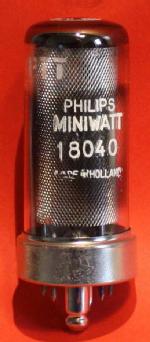

Here is another C3g style tube, 18V 0.2A - The Philips Miniwatt 18040. I am not sure about the pinout - waiting for Gibosi to weigh in.
