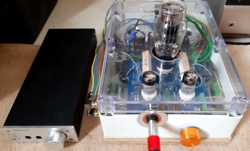

Hello,
I am pretty sure this Douk unit (especially Little Bear P8) is basically a reiteration of a common DIY PCB floating out there (or vice-versa).
It has an SRPP pre-stage(with 2C51 tubes) + a cathode follower at the output (6080 tube).
DC in the signal is then blocked by output capacitors.
I got this PCB some time ago and since completion it's serving as my 'main' unit.
I've populated the board with original parts of my liking plus a few modifications and in my opinion this amp sounds spectacular and is dead silent (powering my HD599).
It has replaced a hot-rodded DIY Lehmann BCL (a very nice solid stage design).
Here are a few pics of the completed unit. Notice the similarities with Douk's unit:
The main differences, should be in the power supply section.
All the heaters are fed by AC current and the B+ is unregulated. As I said, it is dead quiet, even with low impedance cans like my HD599.
I have used separate transformers, one fedding B+ and the 2C51 heaters while the other one is dedicated for the high-current drawing heaters of the 6080.
I've also added an EMI filter for the AC mains, just for the heck of it. I had the space plus it looks nice.
In general, I went with good quality resistors all around (a mix of carbon composition with some carbon/metal films) and larger values for the capacitors. Went a bit overboard with capacitors in series with the signal path (output caps), paralleling several Soviet-era PIO military surplus, Teflon and NOS film along with larger value electrolytics. It took me some time to figure out how they'll all fit inside that enclosure, but in the end i think it was worth it.
