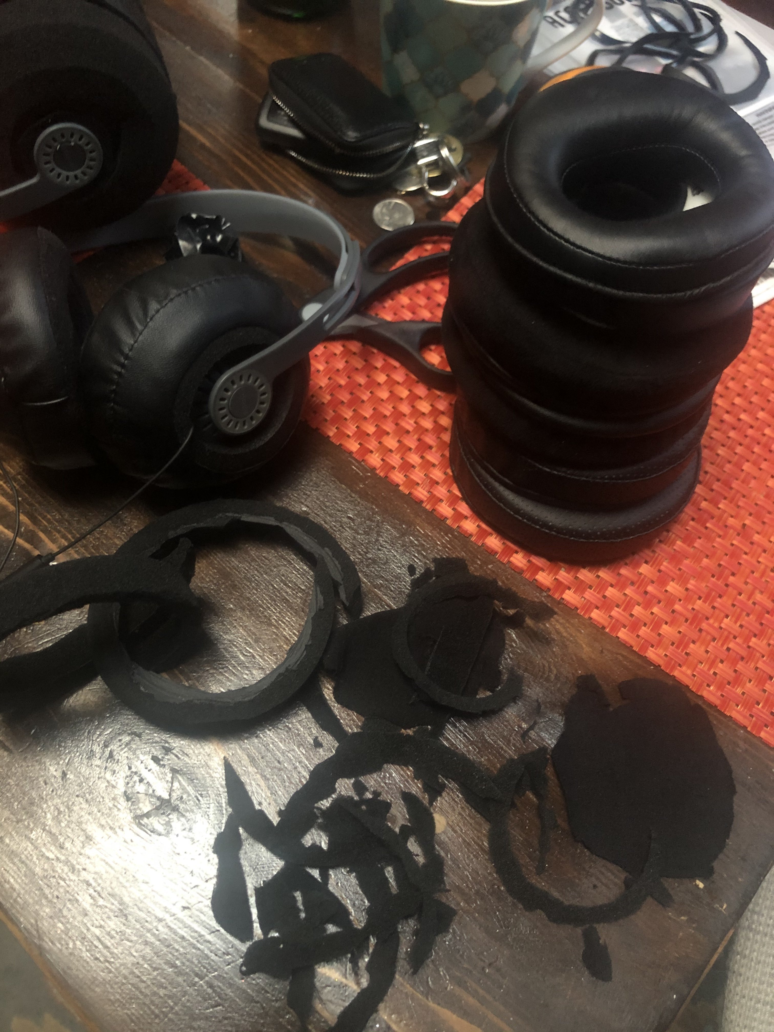

In this mod I was trying to achieve few things. Better comfort than “Grado” pads provide. Retain soundstage to some degree that those Grado pads provide. Make them more presentable and leak less sound to the outside.
What I did was use Grado pads as a foundation. Had to be trimmed on sides and cut flash with the driver on the ear side. All that to fit the hybrid pads. Pads are great as far as sound quality goes. From half a dozen pads that I have tried, these are the ones to get. Not sure what they are replacements for as I bought them for this particular project exclusively. These few steps everyone can do with some scissors and patients.If you’re happy with the results, there’s no need to get crazy with farther tuning. For me, bass was a bit muddy and top end a bit recessed. So I enlarged round opening for driver on Grado pad. It helped but then top end became a bit too sibilant. Not a lot but bothersome still. So I glued extra thin hard felt around the driver, covering all exposed plastic. Inside of the driver cup was sprayed with think coat of liquid rubber. Original tuning foam was reused as in stock. Memory foam was used on the outside to get some better bass definition. Bringing presentation a little closer and improving imaging. Right now, I just finished painting all plastic parts and added some other things. I’ll post a pics tommorow.

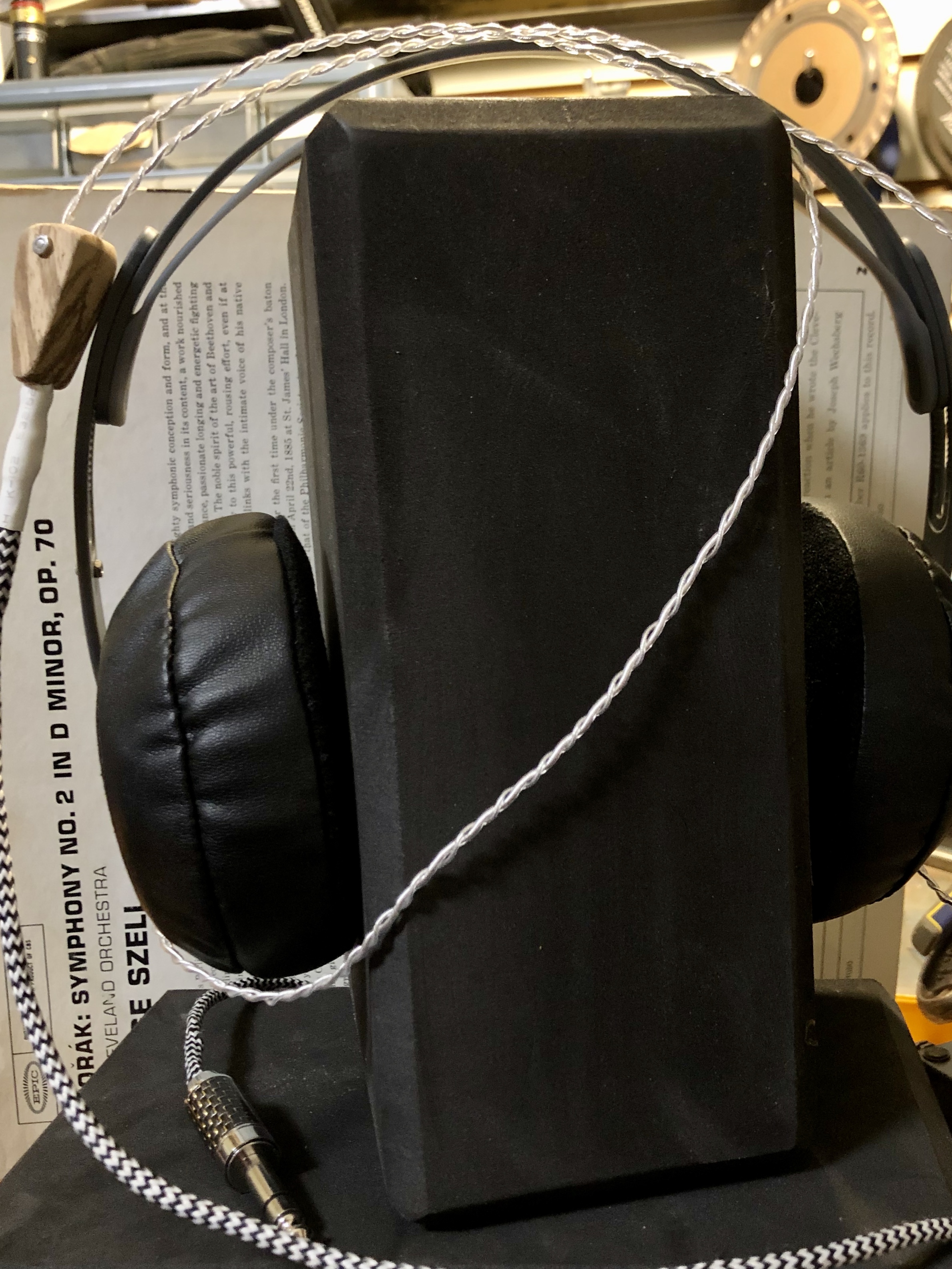

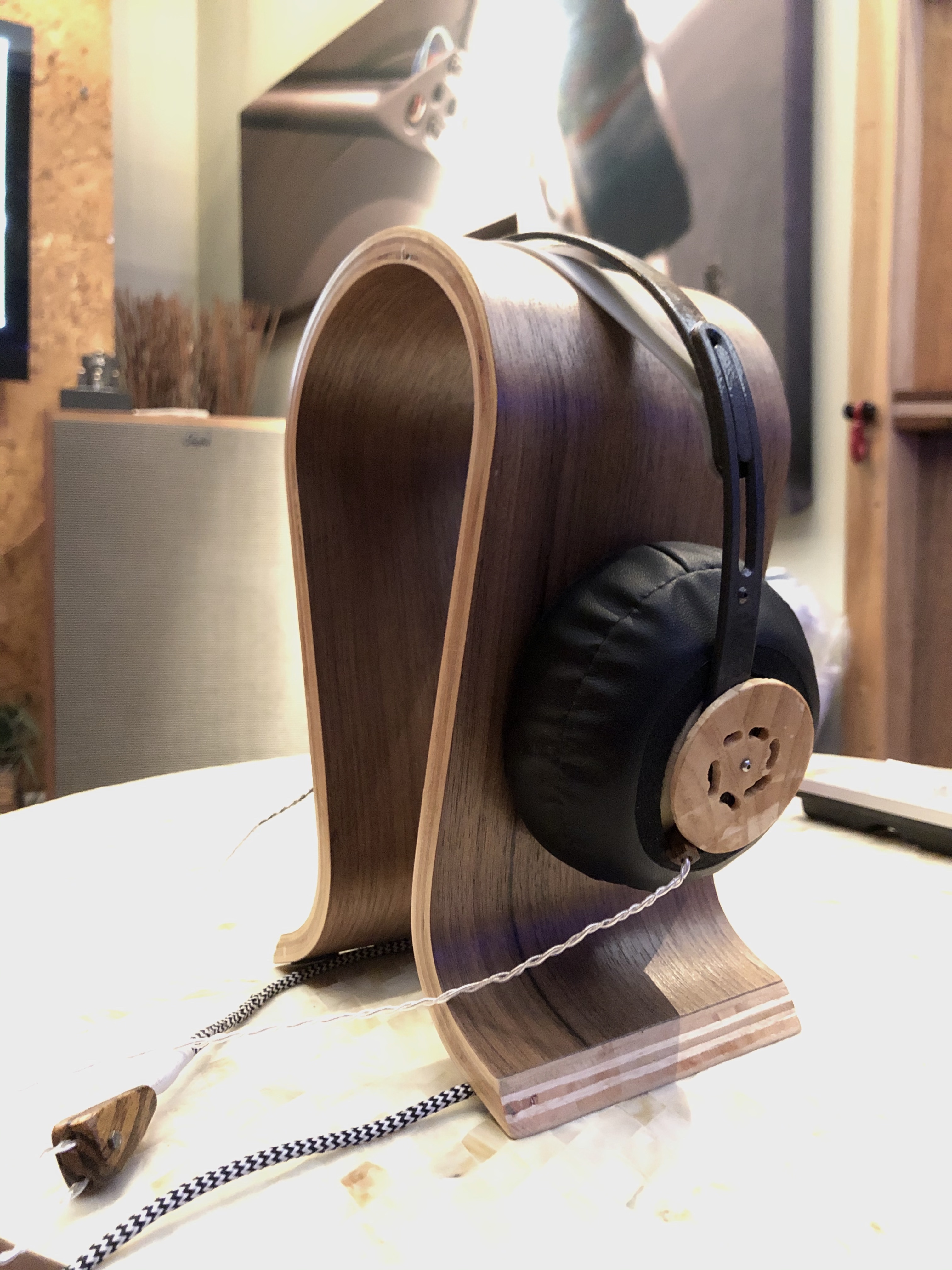

Jan 10, 2021 at 2:10 PM Post #218 of 269
FYFL
Aug 24, 2020
1,058
1,177
nyc
Few pics.
Wood “diffuser/cover” added. Mostly esthetics. Just tested it. Doesn’t affect the sound in any significant way.
Side view. Also added wooden extensions for cable going into headphone-shell. Makes it more secure that’s about it.
Hammered gun metal paint finish
Inside the cup.
Already mentioned memory foam running on the outside part of the shell. Helps with imaging and cleans up bass a bit
Enjoy.
