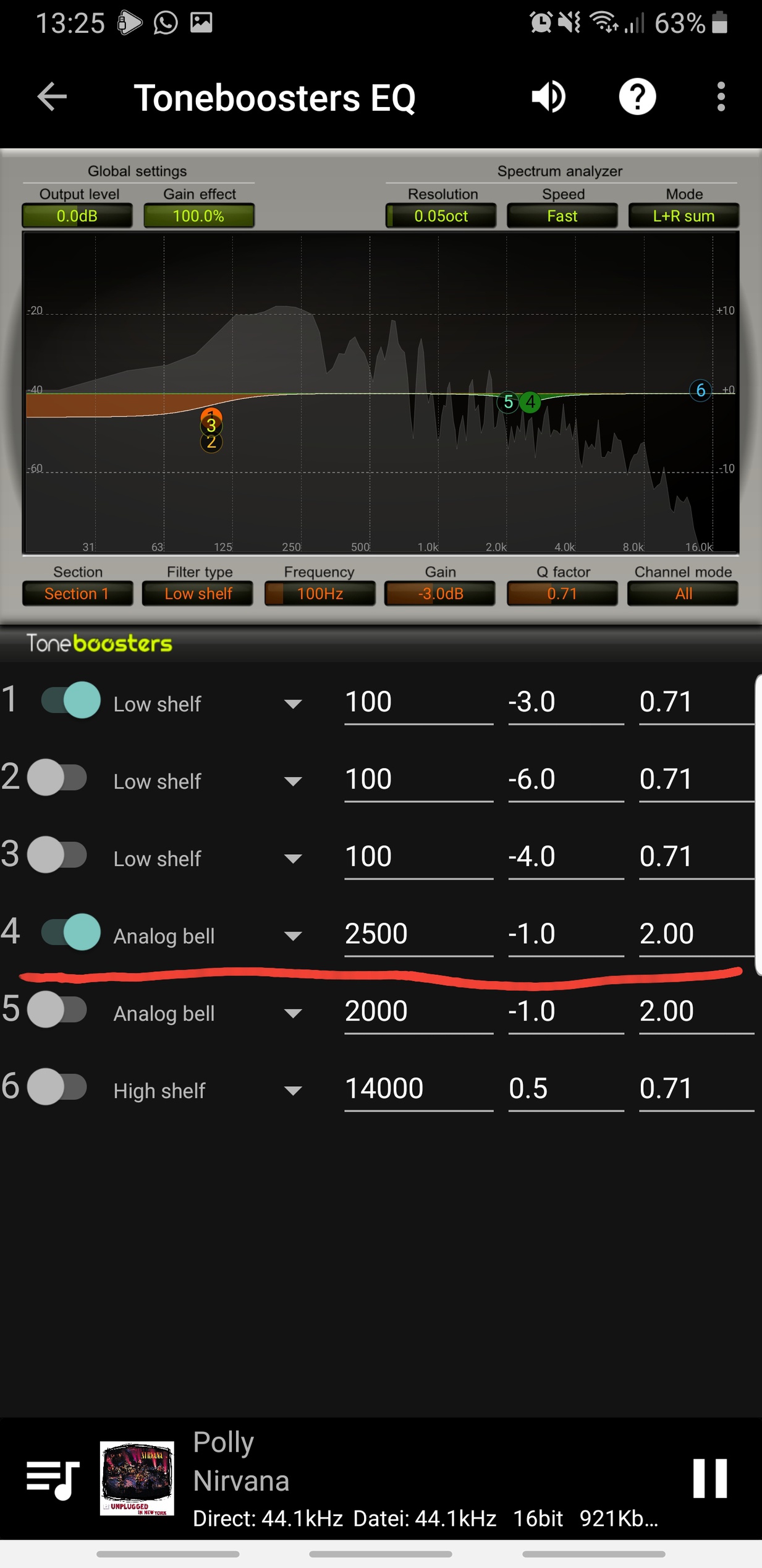

At Nirvana unplugged I noticed a certain sharpness by zs10 pro. When I lower at 2500 Hz 1-2db, the zs10 sounds much more pleasant
reducing sharpness by applying low freq shelfing? that's odd.. what sharpness are you referring to?

Probably I do not know the optimal words in English for what I mean.
Anyway, Curts voice, as well as the acoustic guitar, often sounds uncomfortable in my ears.
With the settings described above, it gets much better.
I am probably very sensitive to these frequencies.
no problem, audio lingo can be confusing sometimes :ksc75smile:
usually sharpness is associated with treble region. from what you did to your ZS10 pro with EQ, it seems like you're reducing all low frequency up to passing the vocal and guitars fundamental freq. it looks to me the ZS10 Pro just has too much bass for your taste
