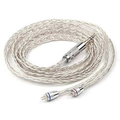

Im using the silver only kz cable (8 core) which tends to oxidize easily. Mine is already green. Picture for reference below.

I'm not using any 8 core cable. Im using the silver only kz cable (4 core) which tends to oxidize easily. Mine is already green. Picture for reference below.
Friend, that’s an 8-core cable :)

I have two pairs of the above 8 core silver KZ cable and the one I have not used as it is still in it's packaging is still in immaculate condition and the one I have used is a bit green lol.
I also bought them both at the same time but it doesn't affect the sound quality so no big deal really.
Aesthetics do matter to me. I am glad I mostly stuck with black cables.
