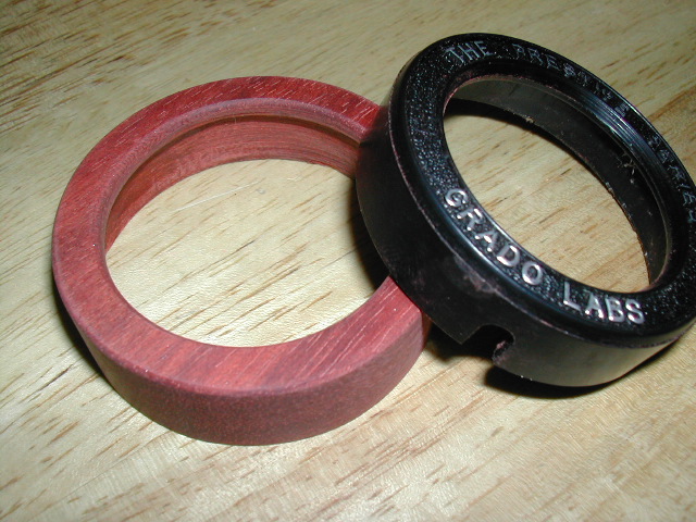

Being that they are naturally bass-heavy, with some odd midrange resonance-colorations I probably would have opted to open them up like you did.  You did the hard part, now just get a dremel and grind everything smooth.  It probably wouldn't be hard to fabricate a cosmetic trim-ring out of wood, stain it all up pretty and cut a mesh screen using perforated sheet metal stock.  I did that a long time ago to my HF1 and it turned out to be my nicest looking headphone.
Mar 4, 2013 at 5:31 PM Post #6 of 11
Your HF1s came out beautifully. I like the idea of a wood ring, something like that might just fit the RX-900s really well. I'm not sure why people think the RX-900s are bass heavy, they're really not. I'd say they have decent extension and a very small midrange bump, but aside from that they sound flat from the mid range down,--- and with that awful felt ring out of the way the highs aren't so recessed and they extend fairly well upwards. The cups work completely against the sound though, it's amazing how capable the drivers in such a cheap headphone are. JVC should seriously consider an open series of headphones. I bet an open version of the DX-1000s would sit very well with the audiophile crowd

Good sound starts with the driver.  If the driver is trash to begin with, then nothing else is going to save it.  A good driver in a "bad" earcup can be modded to surprisingly high standards too, as you have discovered.
In regards to wood fabrication... Wood selection and tool cutting stroke is key.  Some harder woods are hard/brittle with REALLY strong grain structures that are difficult and very labor intensive to work with.  Cutting/grinding against grain on these woods is difficult, but not impossible.  Rosewoods, mahogany come to mind immediately, and they are desired for their acoustic qualities.  At the extreme would be ebony, HARD, brittle and very $$$.  Korina is another timber prized for its acoustic tonal qualities.  Its also hard and difficult to work... and it contains carcenogenic chemicals, you do not want to breathe in its dust.
If you can find hardwood stock thats "sliced" cross grain, that would be ideal, since for the most part your cut strokes would be crossing the grain and not working against it.
For the HF1 I modded, I used Bloodwood.  Not really noted as a "tone wood" (to borrow a term from guitar-fi).  I liked its red-ish color when oiled, so its purely a cosmetic thing.
For your case, being that the wood pieces would be more of a cosmetic trim ring.  I would stick with something thats easy to work with.  Poplar, basswood come to mind immediately.  They are actually good tone woods too, noted for their warm/bassy acoustic qualities in guitar making.  But they are easy to work with and they are porous and soak up stains very well.  A dark walnut stain on these woods with a tung oil on top is not a bad look at all.  Finding stock thats a "pure wood" color might be difficult.  I have seen a lot of basswood and poplar with green and dull-grey color tints.  A lot of kids toys are poplar... easy to work with.
Alder is another option, a bit harder and more pronounced grain structure than poplar / basswood.  But the reward is a nicely contrasting grain structure, and it shouldn't be hard finding alder stock thats not green or odd-colored.
With a headphone as BIG as the RX-900, you should be able to pull it off with a fine tooth jig-saw and hand tools.  A scroll saw would be ideal.
On that HF1 I used a drill press, hole cutters and a wood rasp bit.  God this was almost 10 years ago... fun walk down memory lane.
Mar 5, 2013 at 10:59 PM Post #8 of 11
Thanks for the lengthy explanation, I really wouldn't have known where to start if you hadn't chimed in with your knowledge and past experiences. I'll take my time and hopefully my JVCs will come out half as good as your HF-1s. The JVCs are definitely big
 all the better for amateur modding. If I'm successful I'm probably going to buy a pair of RX700s and open them up as well, I hear they have a more refined sound than the 900s yet they're in the same enclosure for the most part, sounds like they've got just as much potential.
Mar 6, 2013 at 1:52 AM Post #9 of 11
Sure no prob.  Another material I think you should consider is Acetal (or Delrin).  its available in paintable white, black or gray.  Its a semi hard plastic like material thats easy to cut and grind.  It can be sanded smooth and painted too.  I used 3/8" stock to make the top cover LED light fixture for my fish tank... I'd go this route if you're not after the organic wood look.  I am not sure how well glues and epoxy adheres to it though.
