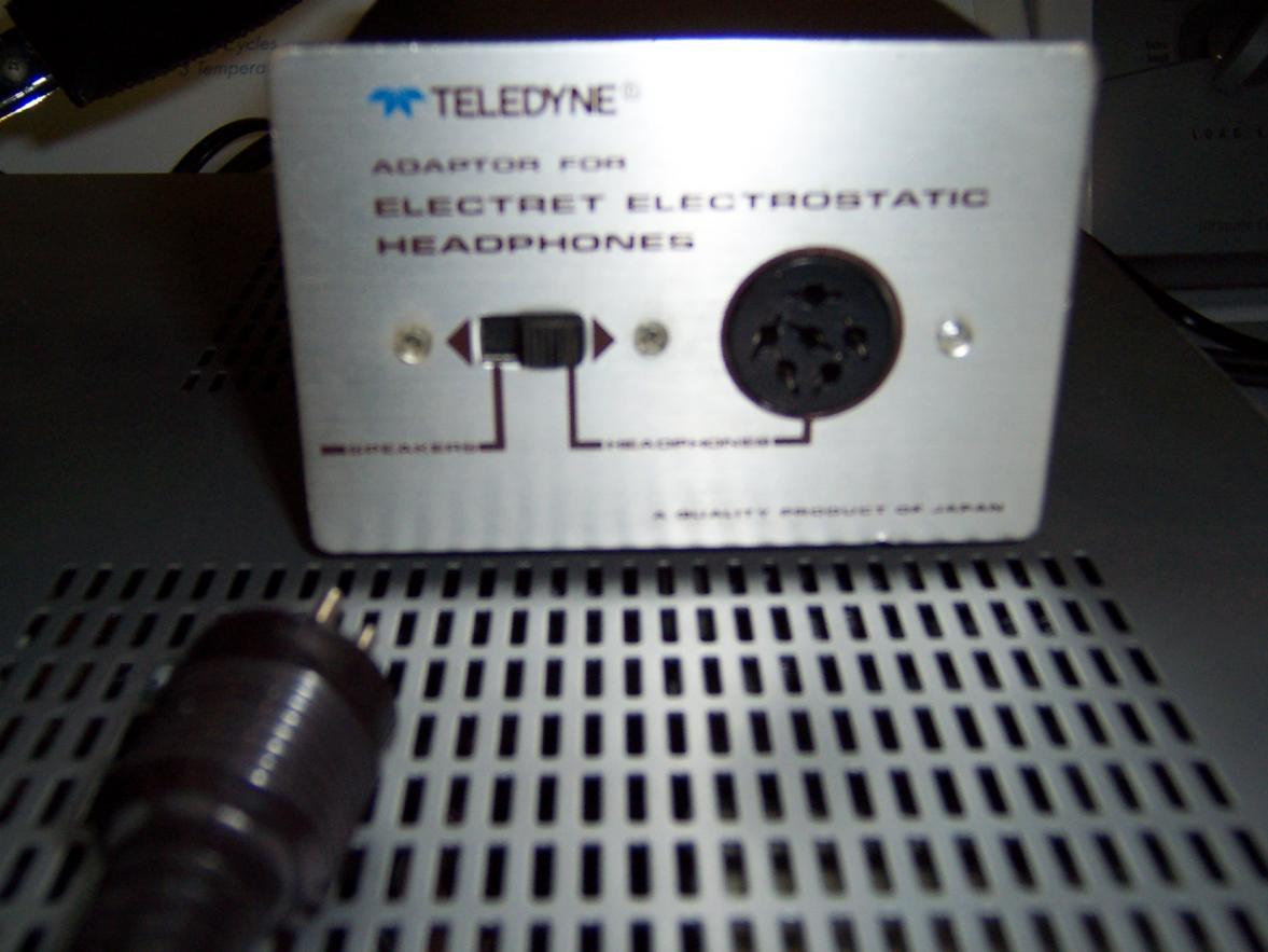

i just got a teledyne vintage electrostat but cant get any sound out of it. i dont have a real amp yet, just a miniature radio shack amp sa-155. i doubt it puts out a few watts per channel. i also tried hooking up the speaker leads from my z-680 and same result- nothing. should a weak amp give some sound or is there a minimum threshold needed to get these going?
also do electrostatic adapter boxes generally have indicator lamps of some kind?

Pictures, especially of the insides, might be helpful in diagnosing your problem.
I'm not familiar with the headphones you have, although theres an evens chance that they're some kind of Stax OEM model, or possibly an electret. Does the transformer have a mains lead? If not then its possible that it's self-biasing of course, in which case the input power will need to reach a certain level in order to bring the phones to life. However 10 good watts should be a sufficiency to get some sound out of them at least.
Also be certain you've not connected up any speaker loop through there may be to the amp rather than the input leads.

heres a few pics. just tried these with a panasonic dvd player/5.1 amp. the satellites are small so i'm sure not much power. i got a whisper out of the headphones rt speaker and a slight sound from the lt. need a real amp! craigslist here i come!

They're electrets, not electrostatics, so there won't be an issue with any bias supply.
Some old electrets do just go dead though, although the old line about all of them inevitably wearing out should be taken with a very large pinch of salt.
Jul 3, 2009 at 2:49 PM Post #12 of 21
Electrets are self-biasing, using a magnet to provide the charge on the membrane rather than external current. Principle of operation is similar to an electrostatic headphone, but the source of the charge on the membrane is not. Once the magnet has died, so has the headphone. Some magnets have a very long life. Others don't.
An electret adapter would attenuate the signal from a power amp to levels appropriate for the headphone, but would not supply bias voltage, since it's not needed.
