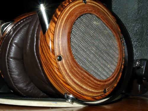

Snorry, author of the first mod, described here, made successful LCD-2 mod. Headphones owner asked him to make sound darker to remove harshness on highs and make sound more smooth.
LCD-2 have much better Phazor alignment, channel imbalance is much better, headpads are equal.
This version features other grill, changed dampers on both size, new hedpads, now easily replaceable and sewn with taking into account headphones' owner anatomy.
Final version photo.

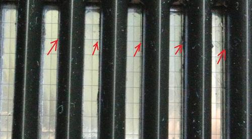

The second mod was not intended to be quite as radical, and only focused on correcting a spike at 8kHz and channel imbalance.  Newly filled pads and a special mount which makes them sit a bit higher (above the fazor), new external grille, correction of fazor position, additional acoustic damping on both sides of fazor, internal grille.
The alignment of tracing on the diaphragm and magnets was slightly off - but equally so on both drivers.  In theory, this would prevent the drivers from realizing their full potential, however, this did not cause any disbalance as both drivers exhibited this equally.

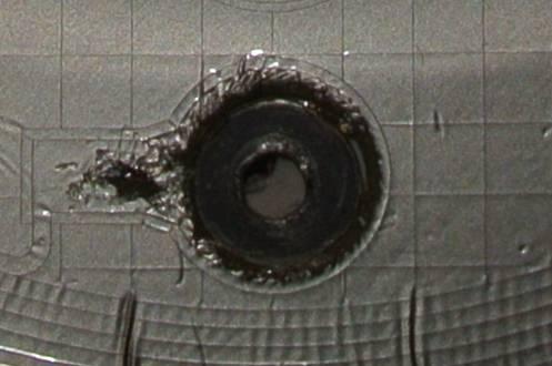

Another interesting item was a subsequent look at the original pads, which showed some unexpected "craftsmanship".

Now they have a 4000 USD LCD-4 headphone coming out. They really should address the build quality issues.
I would love to buy printer paper dampers, misaligned drivers, plastic buzzwords and hair/dust infused magnets. I feel sorry for the poor sap that buys them only to have to return them time after time.
