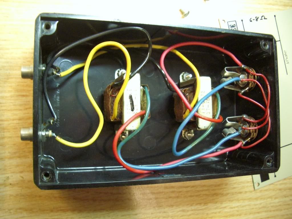

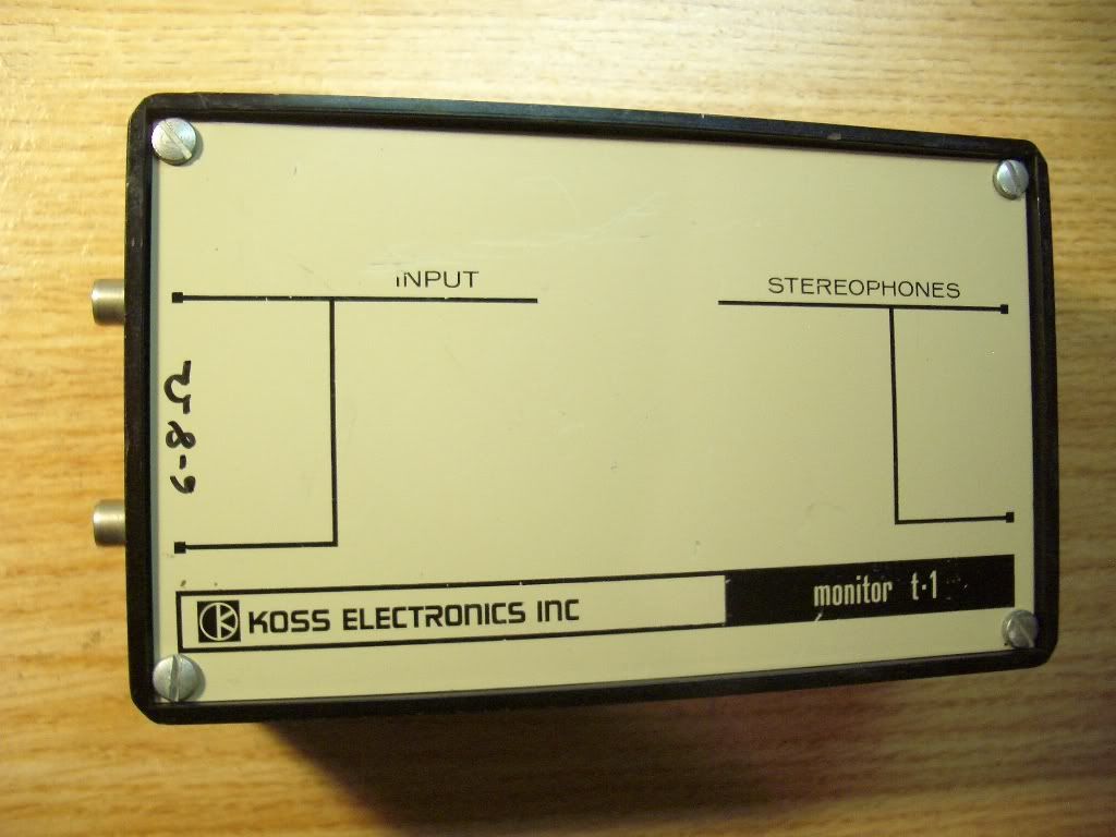

Got a Koss Monitor T-1 adaptor box from a previous deal, have alway thought it is just a box to change RCA speaker out to 1/4" jacks. I finally open it out one day and..... Well, lets say I am now wondering what it was intended for, what kind of headphone is it supposed to drive? Anybody have any info on this thingy?

It looks like an impedance matching transformers...IIRC ASL has one similar the UHC...
Jan 14, 2008 at 3:28 AM Post #6 of 8
Originally Posted by JadeEast /img/forum/go_quote.gif
Stereo to mono impedance adaptor????
It doesn't look mono to me, one transformer per channel, and both channels are on both 1/4 plugs...

both are stereo outputs, the tranformer's DC resistance is 10R for primary and 156R for secondary. I first thought it might be for the old 600 ohm phones, but 8R->600R needs about 1:8..... Has there ever been any 1000+ ohm Koss phones?
This is mostly right, except for your assumption about 8 ohms source impedance, which diverted you from the answer and suggested unusually high impedance headphones.
The T-1 was intended to be used with 4 ohm amp outputs—more common for the time (early 1970s) than the 8 ohms currently used—so the ratio is correct.  To recap, it goes by the square root of the ratio between the input/output impedance.  So sqrt(156 / 10) = sqrt(15.6) = 3.95, which is essential 4 ohms.  This is why you concluded it must be a 1,200 ohm impedance headphone, because as you've doubled the input, so must the output similarly double.
The Koss Catalog circa early 1970s, the piece of the picture you were missing, explains it all:
T-1 Monitoring Adapter
For monitoring tapes from high impedance sources. Adapter contains matching transformers to match 600 to 10,000 ohm outputs down to 4 ohms.  2 output jack for phones, 2 pin-type jacks for inputs.
I hope that answers the question.
And, yes, I own both the catalog and the T-1, although I haven't yet used the T-1.  I'm not the original owner of either, in case that matters.
