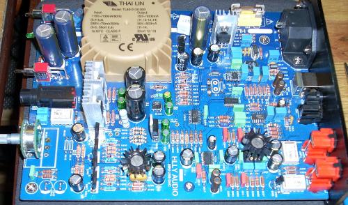

  8. mrarroyo Contributor
    I have been kind of busy the last few weeks modifying this unit and overall I like what I am hearing now. Both of the op-amps have been swapped to LME49720HA with heat sinks. The alps volume pot has been replace with a 21 stepped attenuator using 1% surface mounted resistors.

  14. mrarroyo Contributor
    IMO the LME49720HA is an outstanding sounding op-amp and in many applications the best. I have had great results with them in the HLLY SMK-II and the sound is more open and detailed while maintaining a punchy bass. BTW, I used heat sinks on the op-amps. I have also replaced the volume pot with a cheap attenuator from eBay, see pic below.
