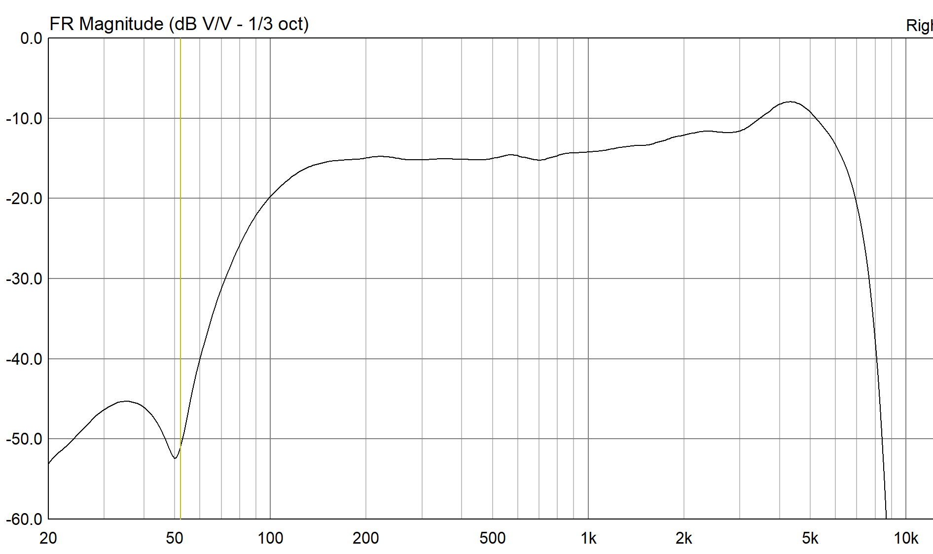

Trying to understand what is wrong with my er2xr measurement via Arta and a Dayton imm-6 mic (didn't load up the calibration file.)
What accounts for the big dip in the sub-bass and lower bass regions? I coupled the iem with a 8mm tube and placed the ety between 1mm to 12 mm distances from the mic with no difference in the overall shape of the graph.
