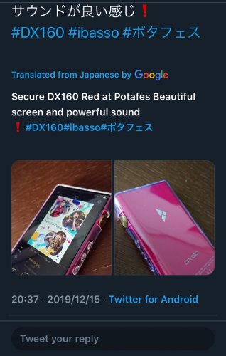

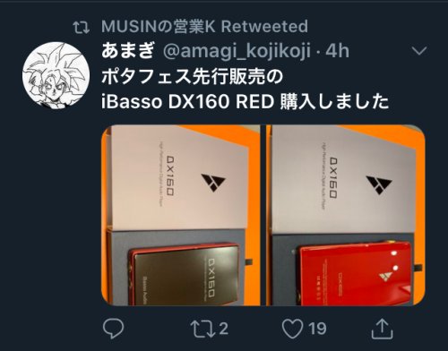

On Twitter there are a few photos of some early release DX160 RED being sold at the e-earphone potafest headphone show this weekend in Tokyo.
@superuser1
Thank you very much for that info.. really appreciate it! @Paul - iBasso could you be kind enough to confirm please!
Me: Gives information.
Forum user: Thanks. Please confirm xxxx company
Me: ...
*Musin is Japans distributor in Japan.
Looks kinda pink with the case in this pic. Lighting?

In 1 picture the red look pink ... so.... when is the pink coming
