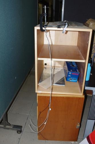

clamp at one end for easy braiding later
http://i1200.photobucket.com/albums/bb329/nekatrall/es7%20mod/IMGP1114.jpg
marking where wires should split (30-45cm fr headphones would be enough)
[img]http://i1200.photobucket.com/albums/bb329/nekatrall/es7%20mod/IMGP1118.jpg
mount on sth abt your height or lower so easier to braid (your choice of braiding litz or chain)
i used a variation of chain braiding so wires dont end up flat
[img]http://i1200.photobucket.com/albums/bb329/nekatrall/es7%20mod/IMGP1122.jpg

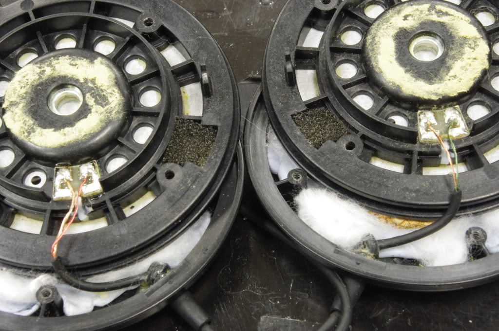

remove the earpad
[img]http://i1200.photobucket.com/albums/bb329/nekatrall/es7%20mod/IMGP1128.jpg
this was taken from a senn hd25 -1 so got extra foam
remove all will reveal screws
[img]http://i1200.photobucket.com/albums/bb329/nekatrall/es7%20mod/IMGP1129.jpg
unscrew both other earphones may be diff - notice tt right signal (red) left signal (green) copper return
[img]http://i1200.photobucket.com/albums/bb329/nekatrall/es7%20mod/IMGP1134.jpg

unsolder and remove the strain relief (easier for smaller wires)
[img]http://i1200.photobucket.com/albums/bb329/nekatrall/es7%20mod/IMGP1139.jpg

wires are too thick so have to remove the rubber grommet to fit in
[img]http://i1200.photobucket.com/albums/bb329/nekatrall/es7%20mod/IMGP1147.jpg
solder the wires in
here do be careful and make sure all things cool down as the glue on the driver is soften and may break away from the driver rendering ur headphones useless.
something i learnt the hard way so carefully put it back in place be paitent
