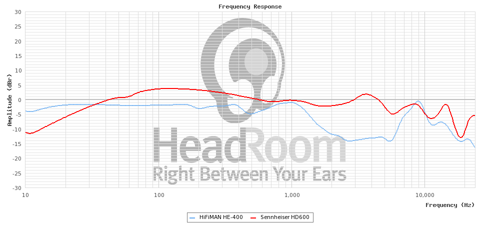

Unless you're listening to music that has very loud low bass the only thing that will really matter as far as the sound is concerned is how smooth the frequency response is. There is no headphone nor speaker with a perfectly flat response graph, unlike amps and DACs, due to current technological limitations. Generally you'd want to avoid headphones with very narrow and tall spikes/deep dips in the response, and the whole range needs to be as flat as possible. For example, even if the response looks smooth in shape but it actually hollows out past 1khz and then has a spike high up in the treble range, your ears will likely perceive that spike to be louder than it is since the frequencies around/preceding it are relatively weaker. That's basically the HD700 compared to, say, the HD650 and K702.
Still, as much as that would help to scientifically narrow down your choices, there are other considerations. In some cases you might have a headphone that has a plateau that gets in the way of hearing the other frequencies properly vs a headphone with a relatively very flat response in the same region, but has a problematic response in another part of the range. Let's take the HE-400 for example - it has a wide "hole" in the upper midrange-treble area but it's as flat as you can get at that price range from 1khz down to 30hz. That means the bass and most of the percussion are about as natural as you can get, but you can have a noticeable difference in the vocals for example. Still, it's not a bad headphone, it depends on what kind of compromise you would rather make.
