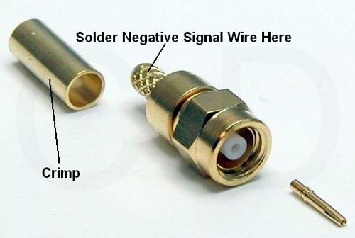

You don't have to unbraid your cable!
I made a balanced cable for my HE-500 using the extra SMC connectors included in the HE-500 box and Canare Star Quad cable but modifying the original cable is easy.
Cut the TRS connector about 1 foot from the connector--keep the cutoff as you may want to solder on a 4-Pin Female XLR to use as an adapter cable.
Trim about 1/8 of an inch (3mm) of insulation from the 4 headphone wires.
Unscrew the headset's right SMC connector. If it won't come off with fingers a small wrench will work.
Using a multimeter's continuity feature (touch the two probes together and you'll hear a tone--this is sometimes marked on the multimeter's dial as a musical note) touch one probe to the outside of the SMC connector then touch each of the 4 bare wires. When the meter beeps you found the wire connected to the outside of the SMC which will be Right negative, so mark the cable somehow so you'll know what it is when soldering.
Touch one probe to the center pin of the SMC connector and look for its wire, that will be Right +
Do the same for the other SMC connector which will be Left - for the outside of the SMC connector, Left + for the center pin.
HiFiMan Male SMC connector (get extras on eBay):
Solder on the 4-Pin XLR connector. The pin numbers are actually molded into the XLR's plastic plug that has the 4 pins through it. Don't forget to slide on the XLR shroud before you start to solder. For braided line like this I would also recommend putting some heat-shrink tubing over the part of the cable that will be under the shroud. It will help the XLR cable lock grip the wires.
XLR Pin
1  L+
2  L-
3  R+
4  R-
The view when soldering the XLR connector:
I have a balanced cable DIY webpage here: http://robrobinette.com/BalancedCable.htm
