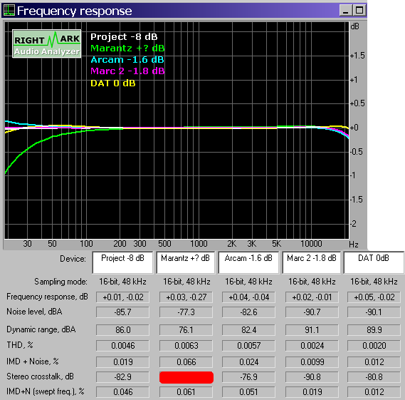

Bare outputs
The level in dB shows, very approximately, the volume compared to a line output.
Thus, the noise level is to be compared with this volume. The quieter an output plays, the lower is the signal to noise ratio.
For comparison, the headphone.com website gives the harmonic distortion for three of our headphones :
If we assume that we can read, taking into account the fact that we must sum the different harmonic peaks in a logarithmic way, -70 db for the DT880, -73 dB for the HD600, and -85 db for the Creative, this translates into
DT880 : 0.03 %
HD600 : 0.02 %
Creative : 0.005 %
In all cases, this is well below the audible threshold.
The noise level is low on the Pro-ject (given the measurment level), the Marian and the DAT. The power amplifiers are noisier. A bit for the Arcam, more for the Marantz.
We also noted the level for each channel. The Pro-ject is quite unbalanced with 0.7 dB of difference between the left channel and the right channel at the listening level for hifi headphones, and 1.5 dB of difference at the level for earphones (11 db lower). And it doesn't feature a balance setting. Too bad for a dedicated headphone amplifier.
The Arcam and the Marc 2 soundcard are perfectly balanced (less than 0.2 db of difference at low and high level).
The Marantz and the DAT output have 1.2 db of difference between the left and the right channel at the listening level for hifi headphones (if we assume that the soundcard, that measured the DAT, is itself balanced) ! Oddly enough, the difference is only 0.6 db for the DAT and 0.2 dB for the Marantz at low level, for earphones.

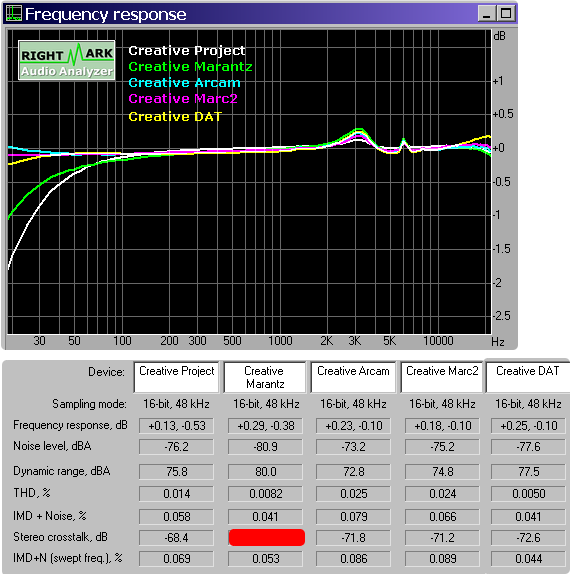

Now, here is the behaviour of our outputs, loaded with the Creative earphones, at a listening level that seemed average to us, except on the Marantz, very loud (we have not had the time to carefully adjust the levels).
Very neutral in all cases. The lack of bass of the Marantz have stayed the same, but the Pro-ject falls at -1 dB at 30 Hz loaded with the earphones. This is very probably inaudible.
There have been a bug with the Marantz measurments. For an unknown reason, RMAA pretends that the recording are clipped, while they are not. And the crosstalk measurment is in contradiction with the test signal recorded (RMAA says -6 dB). I have masked the number in the table.

That the soundcard seemed to be able to output higher levels with similar quality.
That the Beyer DT880 is easier to feed with neutrality than the Sennheiser HD600, itself easier than the AKG K-400.
That integrated amplifiers seem to have more background noise than dedicated headphone outputs (save basic headphone outputs on computers, and maybe nomad player outputs).
...and that it remains, in order to get a general idea, to test the possible listening level, maximum as well as minimum, and the background noise according to the amplifier and headphones. It would also be interesting to test a nomad player output. Nitri had brought a Creative player, which can play wav files, but we lacked the mini-jack adapter in order to perform the measurments.
