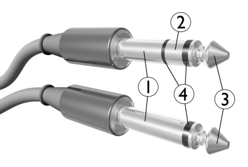

Skipping the science on it, a balanced analog connection uses three cables to carry the signals whereas in unbalanced audio you use only two cables. Typically, unbalanced audio runs off an RCA cable, or when they do on TRS connectors, it is from a 3.5mm* going to a single 3.5mm* or 6.3mm,* twin mono 6.3mm** or twin RCA. Balanced audio travels through XLR cables, or when they use TRS conncectors, they use 3-conductor TRS* cables. Those JBLs have both of these.
An active monitor for example can still have unbalanced inputs even with two 6.3mm jacks on each speaker, mainly because professional monitors are symmetrically designed - each monitor has its own amplifier built into it - whereas active monitors built more for home audio listeners are simplified. These have a master speaker, which has the amplifier for both, and these are the ones that have only the "singular (TRS) jack" and only a speaker cable carrying the signal to the speaker on the other side. Here, you only hook up one speaker to AC power, and some have an iPod dock on the master speaker cabinet.
*this one will have two rings on the plug, indicating a third conductor (see below)
**this one will have one ring on the plug, indicating only two conductors (see below)
