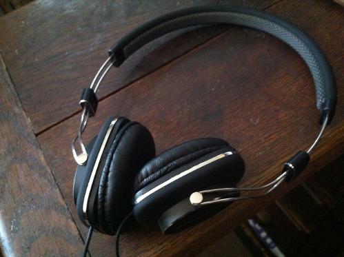

As a lot of people have discovered, while an overall nice sound and amazing design, there's a sort of bass bloated-ness that bleeds into the mids with these headphones, and makes for a sort of muffled sound. For many, this is unacceptable in a 200 dollar headset, no matter how well designed.
Well, I did a lot of messing around, and I discovered that the actual drivers of the P3 are stellar. It's the pads that are causing the sound distortion. This may not be news to many of you.
I had an old pair of JVC flats laying around, and it was the first gen which had slightly bigger ear pads. They are almost the right size for the P3, maybe just a little on the small side. Anyway, I took the P3's pads off, complete with the magnetic plates they are attached to, and put the JVC flats pads on my ears, and put the headphones on (I didn't have them glued or anything like that yet, they were just being held in place by the pressure of the headphones).
What I noticed was that the sound did two things: 1, it became much brighter and more open. No muffle, no overly warm sound signature. The sound became much clearer and more articulate. 2, the overall balanced improved drastically. The bass dropped by at least 30%. All of a sudden I could hear the mids. The bass was still rather good, as well. More than say, the PX 200s.
So I proceeded to tear everything off of the magnetic strips that go onto the P3 headphones. I tore off the nice fabric and foam. It felt bad, but I knew it had to be done. So, after an experiment with putting the magnetic plates back on without the padding, I then again put the JVC pads on my ears and tried out the headphones. The sound was still muffled and overly bassy.
How could this be? I believe the answer was in the magnetic plates themselves. In the back of the plates and around the opening, there was still a lot of adhesive fabric like material, as well as a rubber ring around the inside opening of the plates where the sound comes through. I took all of this off, and repeated the experiment with the JVC flat's pads.
BINGO! It turns out, for whatever reason all of that extra material on the back and inside of the plates were causing some sort of seal that was bloating the bass. Thinking about it more, I think it was the rubber right around where the speaker opening was.
So, I took the final step, and super glued the JVC pads to the plates. It's not as nice looking, but the sound has improved so much, plus I actually find it more comfortable, oddly enough.
Here's what the pads look like:
IF you have nicer pads laying around of the same size, they would also probably work. Also, this is completely reversible as long as you're ok with mutilating a probably expensive set of ear pads. The headphones themselves aren't being altered in any way.
